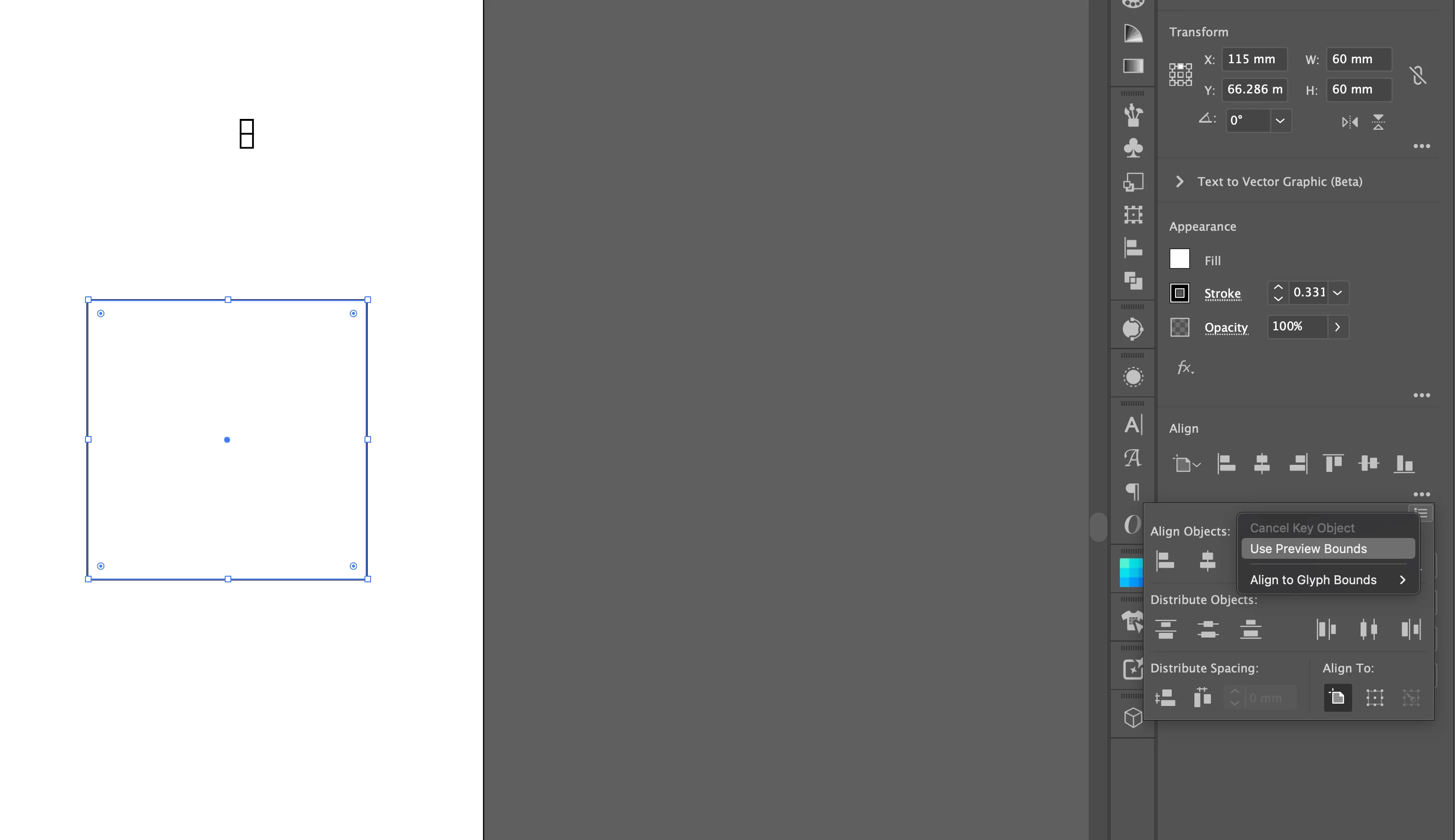

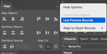

did you try deselect "use preview bounds" in the align box?

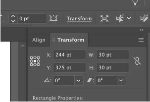

Just to be sure, Daniel, take the selection arrow, do not select anything, and check what the Property panel looks like. If the middle right icon for pixel alignment is switch ON, then all new objects will be drawn and aligned to a pixel grid. And 300 mm indeed becomes exactly 299,861 mm...
