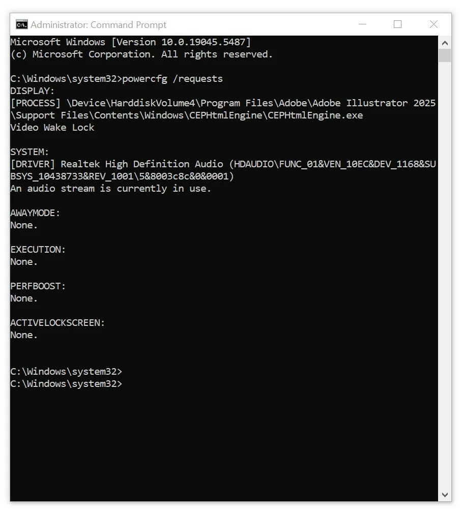

BUG Report: Illustrator 2025 CEPHtmlEngine Video Wake Lock Prevents Screen Saver
ISSUE: Illustrator 2025’s CEPHtmlEngine.exe issues a Video Wake Lock, preventing screen saver and display timeout.  (causing potential screen burn-in and unneccesary power use)
OS: Windows 10, version 19045.5487
GPU: Intel ARC A770, Driver 31.0.101.5382
Steps to Reproduce:
1. Open Illustrator 2025 or let it run in the background
2. Set screen saver to 5 minutes, display off to 10 minutes in Windows settings.
3. Wait—nothing triggers screen saver or screen power event, no events posted in Event Viewer
4. Kill all "CEPHtmlEngine.exe" processes in Task Manager
5. Wait
6. Result: Screen saver and power timeouts trigger properly at 5 and 10 minute marks
Issue located with the assistance of Grok AI instructions as follows...
To detect, open: CMD (elevated) and enter "powercfg /requests"
Output: DISPLAY: [PROCESS] ... CEPHtmlEngine.exe - Video Wake Lock
(screenshot attached)

UPDATE:
Adobe seems to have read my mind.  With the newest update (Illustrator 29.3.1) installed today, the issue seems to be resolved.  It's only been a few hours, but I am optimistic because my PC is back to functioning normally as it concerns the screen saver and power setting for the monitor.  If you don't have at least this version and you have the issue, perhaps try updating.  Thanks, Adobe!
