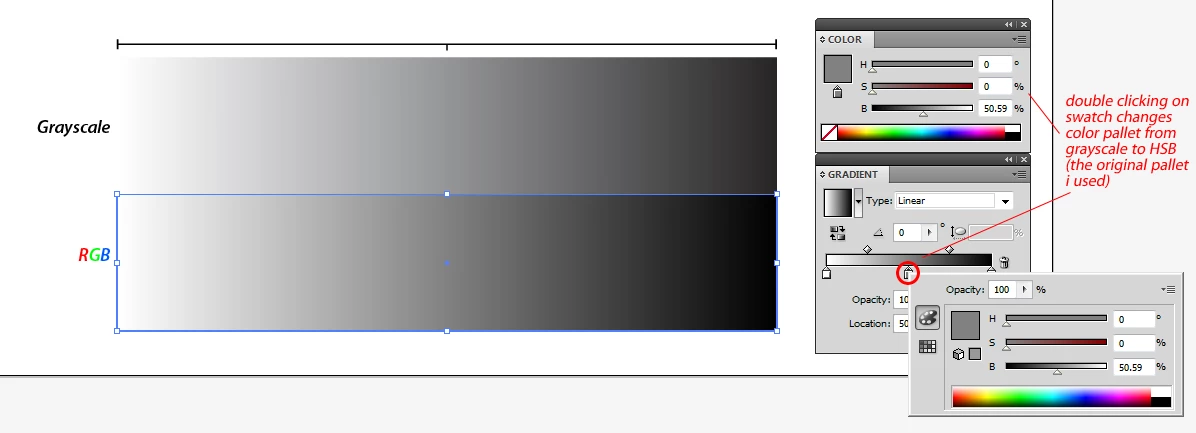

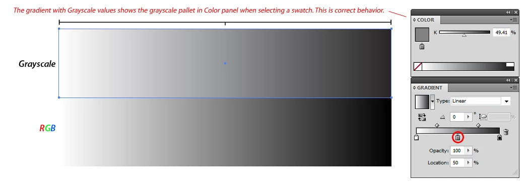

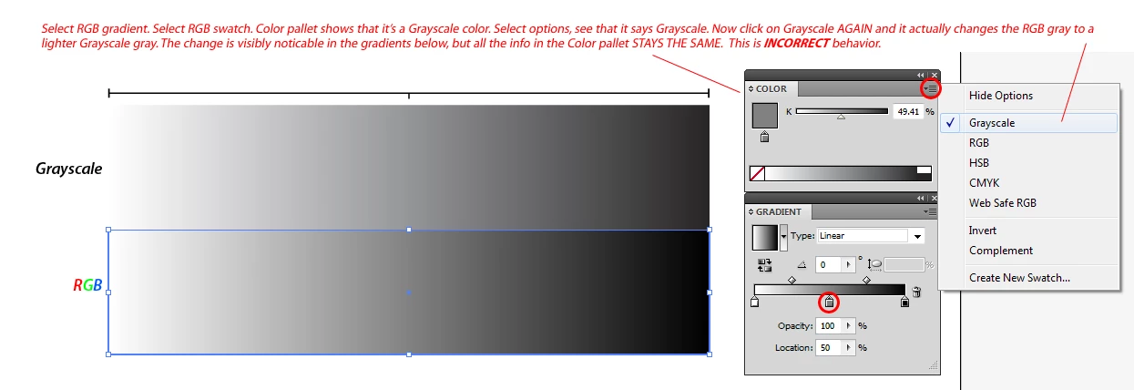

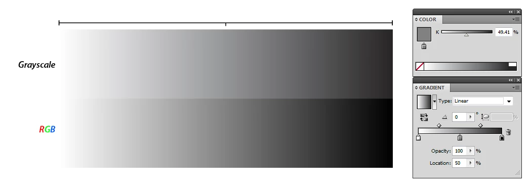

    Mike, i was able to reproduce it by doing this:
    1. Create RGB-space ai file. Create two different gradients. One with all grayscale values and one with RGB values.
    2. Save and close the ai file.
    3. Open the file and there you will see the problem. Check out the screenshots/files i attached.
    Things i noticed: when double-clicking on the gradient swatch the color space in the Color panel changes from Grayscale (wrong pallet) to HSB (right pallet). But if you use the Color panel to change your value all hell will break loose.
    Bottom line: when a gray swatch is selected in the gradient panel, the information in the Color panel should represent the real color space that the gray swatch is using (which in this case should be HSB, not Grayscale).
    AI file: http://dl.dropbox.com/u/1053706/greyscale.ai
    I hope this explains the problem in more detail.
    -Sergie

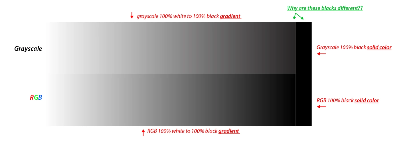

    Here's another weird thing:
    Why does a grayscale black look different in a gradient and a solid color. Here's a screenshot showing this visually (click to enlarge):
    Am i getting something wrong here? This just seems really weird!
    -Sergie
