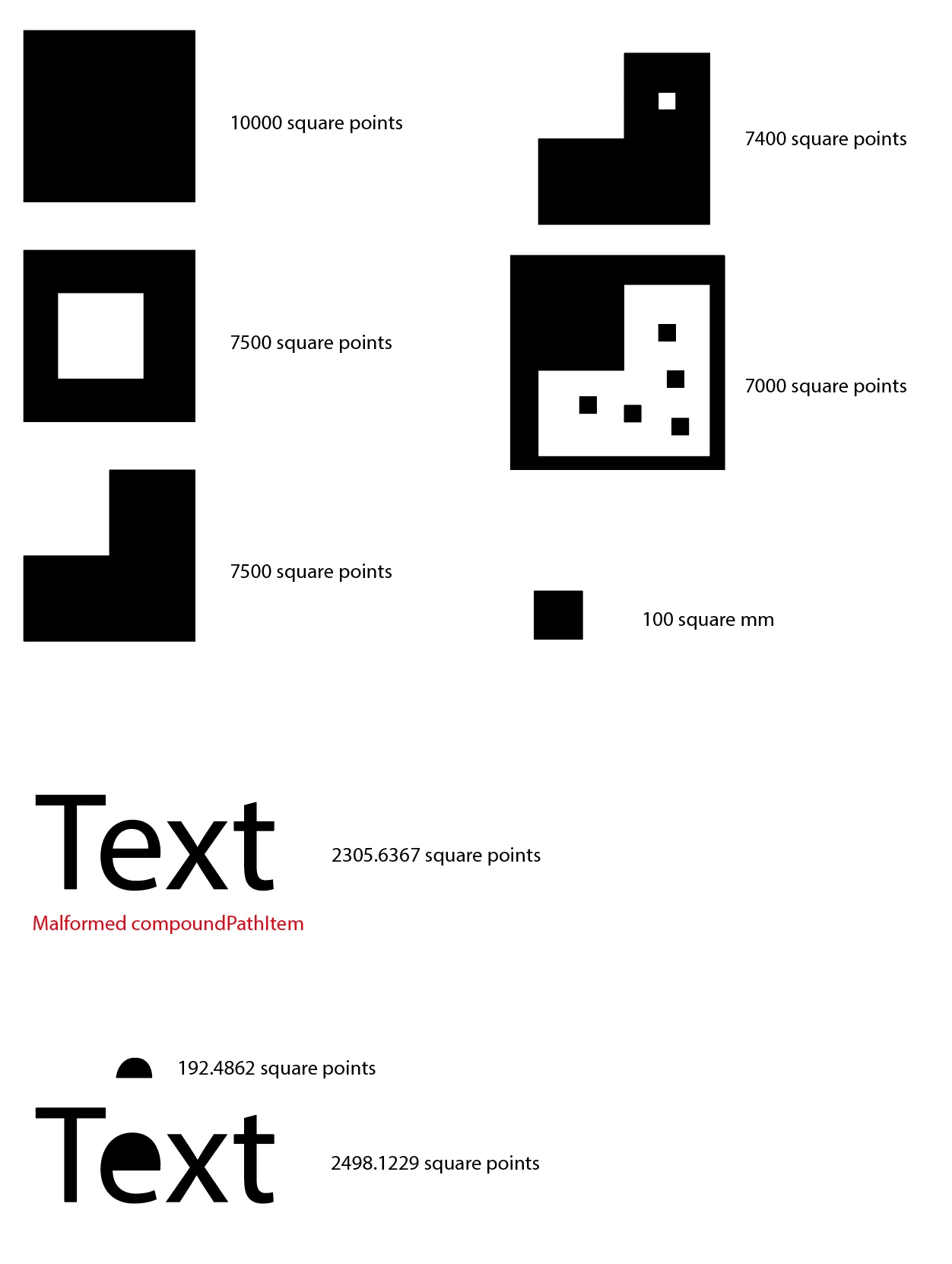

Hi @YannickB833 and @Jacob Bugge, this is a new topic for me so forgive me if I am going over old ground. I wrote a quick function getItemArea to attempt to do this.
I have tested on some basic cases (see attached sample file) but I am guessing by your post that it is more complicated than I can see. You can specify the units as 'mm', 'cm', 'inch' or 'pt' (default).
One complicated example I did find was that a compoundPath may be malformed quite easily: if you create a compoundPath out of grouped compoundPaths (for example if you outline text and then, without ungrouping, create compoundPath of it—as I did in the attached sample doc) then it will have zero pathItems. The script makes an attempt to fix this—but see caveats in script listing.
@YannickB833,  please let me know how it works in your case, and post example .ai file that shows unexpected result.
- Mark

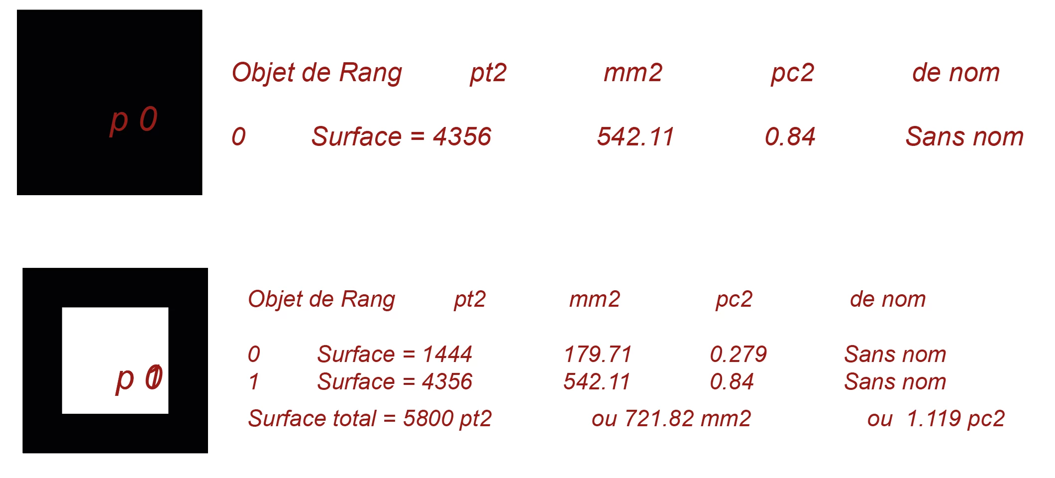

Thanks for your answer,
If you look at the second result we have the area of first shape ADDED to the area of the white shape (i add that in reallity there is no white shape it's a Compound Path), but what i want is only the BLACK surface of the second shape : 542-179=363 millimeters
It's easy in this case, but with a lot of more objects it become less funny ....
the goal is to be able to determinate the black surface, with this data i can calculate a production time
But it's currently flawed cause of this king of situation
Is it more clear ?
Sorry for my bad explanations !

Hi @YannickB833, can you explain how it isn't working? When I look at your screen shot, it looks okay. The top case item 0 is the uppercase O. In the bottom case item 0 is the numeral 1 and item 1 is the uppercase O. The area values match up.
I can suggest a test case: compare the uppercase O, with just the outside path of the uppercase O.
Sorry if I have misunderstood.
- Mark
