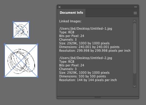

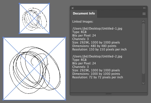

Your script is giving different answers for the placed files most likely because they have different resolutions (ppi). Not every placed file has a resolution of 72 ppi, but that is the number you are using in your calculation.
If you look at the screenshot below, you can see two almost identical images. The only difference is one is saved at 150 ppi and the other at 72 ppi. Both were only placed and not scaled. If you look carefully, they are the exact same pixel and file size but they have different physical sizes (dimensions in Ai). This is because of their set ppi.
Now, If I scale both placed images down by 50% your calculation would yield 72 / .5 = 144 for both images. And as you can see from the Document Info palette below that isn't correct.
The correct calculation should be `Math.abs(originalImagePPI / item.matrix.mValueA);`, the problem is, I am not aware of a native way to get the original file ppi information from the Illustrator API. You can probably use BridgeTalk and Photoshop to get it but that would not be fun. Obviously, Ai has the information since it's displayed in the Document Info palette, I just don't think it is exposed via the API.

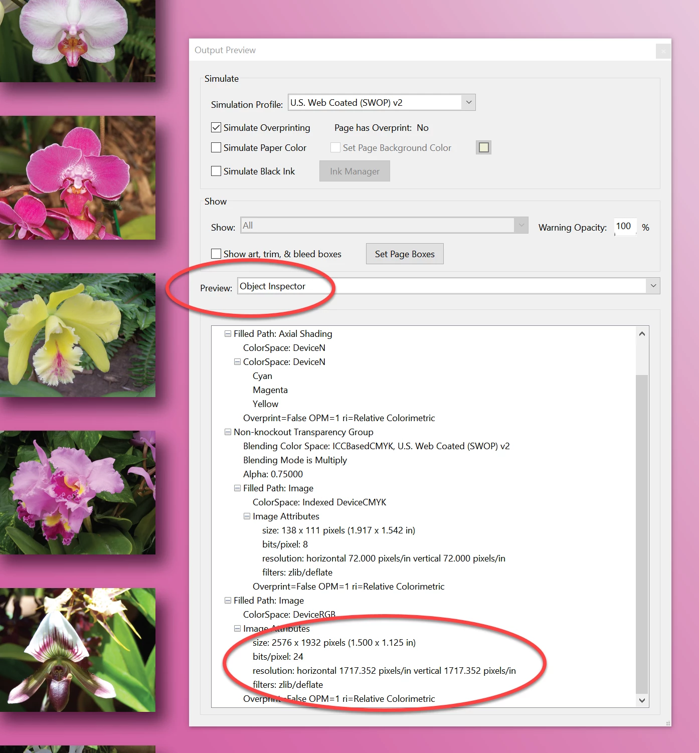

As you change the scale, the effective resolution goes in the opposite direction. If you scale an image up to 1.33x%, the resolution drops by 25%. If you scale the image down to 50%, the resolution increases by 200%.
Unless I'm misunderstanding what you want, PPI should be a simple native pixel width / layout width. Height should be the same PPI unless the image is distorted. 72 pixels per inch does not come into play for PPI. For example: The original resolution of 3000 pixels at a width of 10 inches would be 300 ppi; at 5 inches, it would be 600 ppi; at 20 inches, it would be 15o ppi.
You can check the image info in Acrobat with the Print Production tools:
