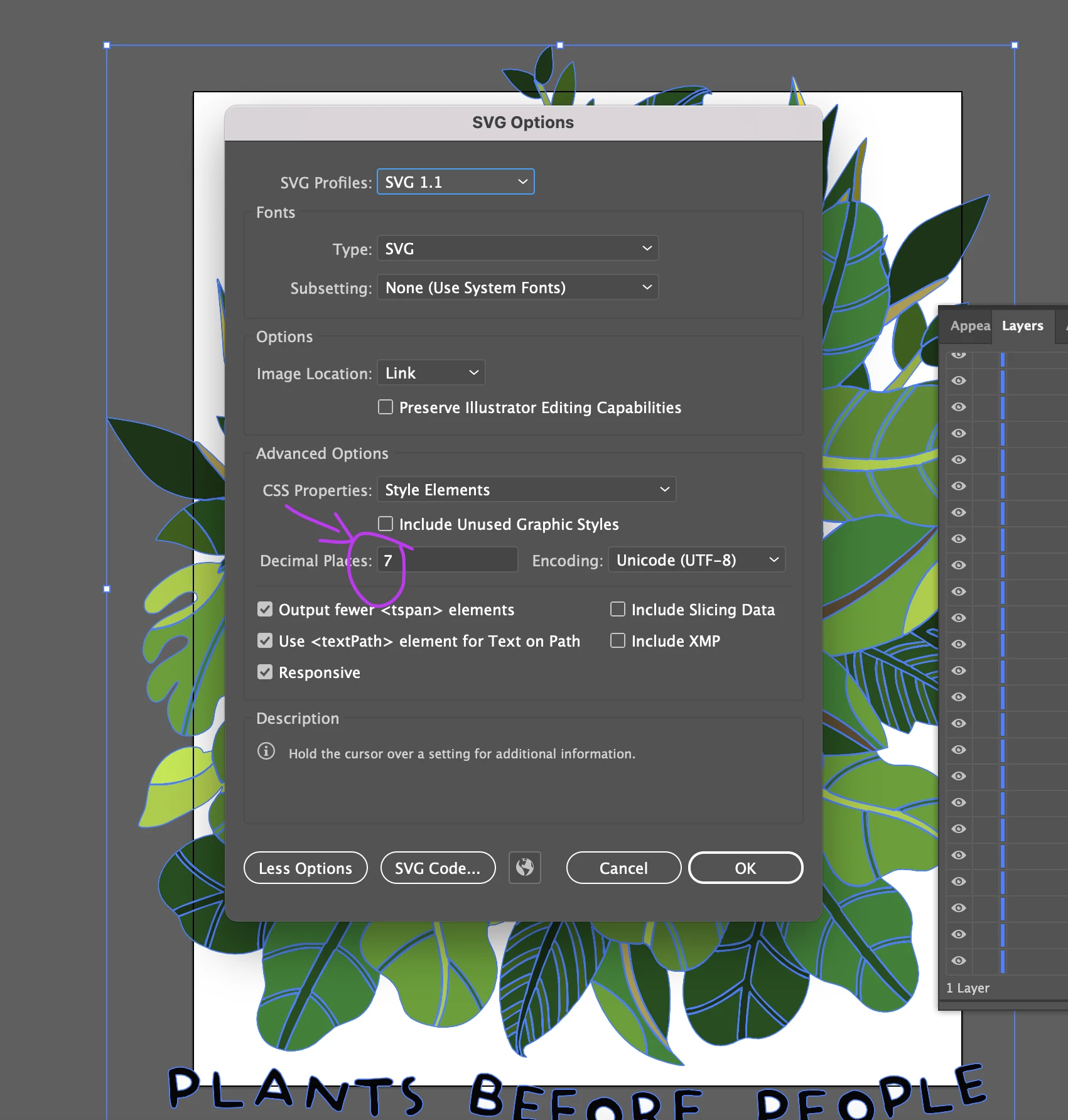

I know this is SUPER LATE but I have the answer whoohoooo!!!
This number circled must be 7 or above when saving.
I may be wrong and I am quite a novice but it works, try it!!

This will make tracing work better in Illustrator, or will it make the svg export look better somehow?
Monika Gause
September 29, 2022
It won't affect the tracing itself in any way. It will only make sure that the path you export won't get distorted further.
The "Save as" creates old code. Better to use "Asset export" resp "Export for screens". It will only accept 5 decimal places. But the Save as will only export 5 either. https://bjango.com/articles/svgpassthroughprecision/
