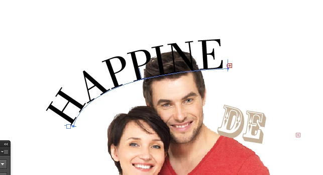

Hi guys,
Can i modify the line path shape in Text on Path? Like if i were modifying a regular stroke path.
I want to extend the line or path to change it curve so my text do not overflow. I would like to make the text longer but with the same size. So next to edit the line not the text. I find that when ever i click the Selection (black arrow) or Direct Selection (white arrow) tool i cannot tweak the line path just the text. Maybe this is very easy to do but i cannot figure it out.
Here is a sample
Thanks!

    With the direct selection tool you will need to select the path. Click on the path or the anchors, not anywhere else.

    Thanks for the info! i manage to solve it with your tip. However it is a bit tricky just on the anchors sometimes.
