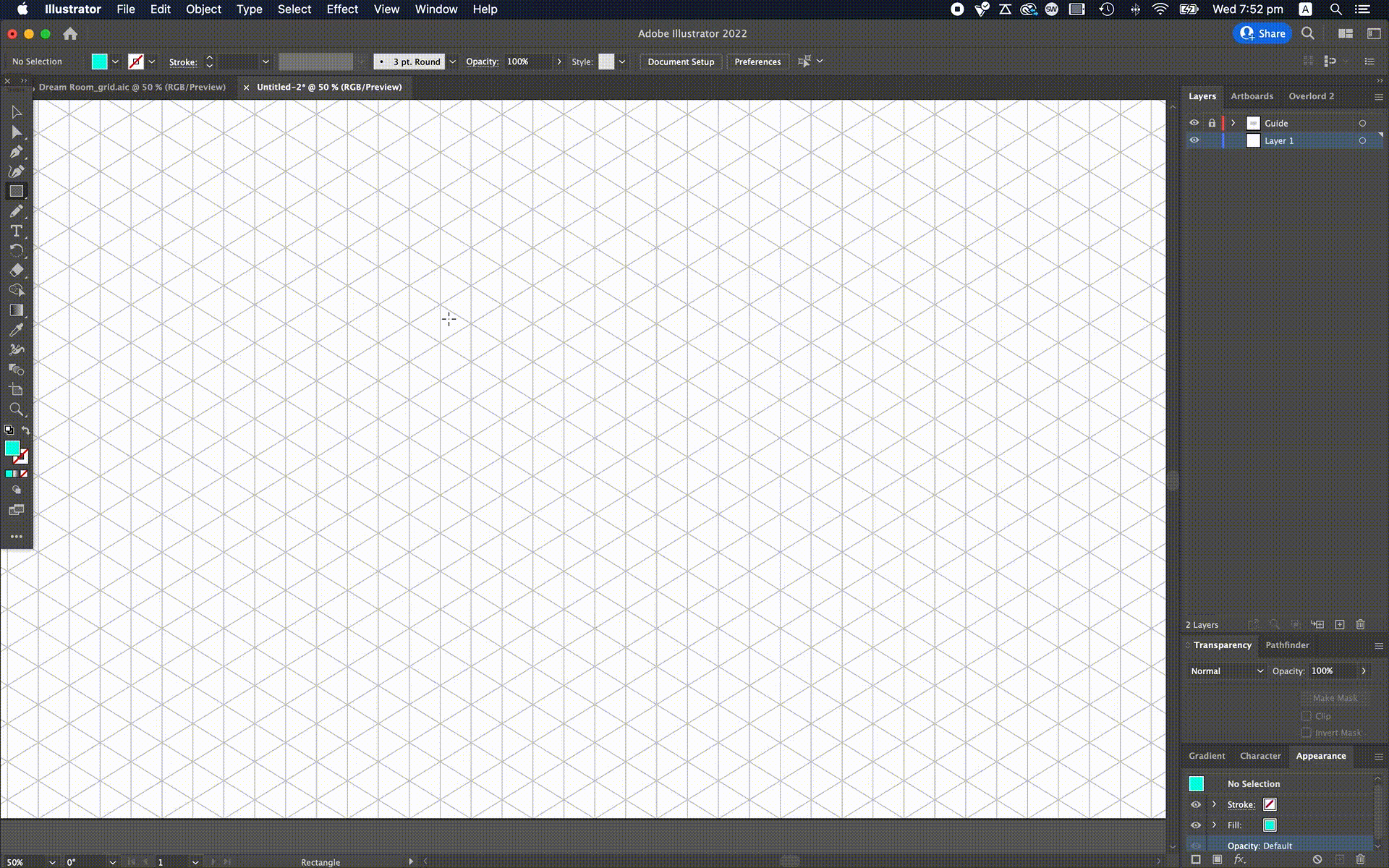

Hi everyone.
I tried to draw isomatric.
Top layer is isomatric guides made of stroke and 2nd one is drawing place.
The guide is low opacity and I tryed to drarw along it.

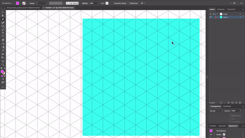

my problem is that draw a filled solid but smart guides is not woking on the filled solid along the guide.
Is it my illustrator setting wrong or someting?
My IA is CC 2022

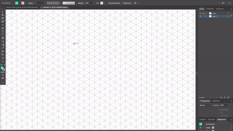

Unlock your top layer "Guide" that contains the grid.
One may think that it should also work if that layer is locked, but it doesn't.
Jan 30, 2025 4:35 AM UTC
Thank you reply!
Well, I can draw when unlock the guide layer, but happening pen tool is not able to finish.
You said that, but I saw locked guide layer working on nothers tutorial video (eg YouTude etc). Unfortunaly it does not teach me how to do. So I think Ai can.
Kurt Gold
Jan 30, 2025 8:00 PM UTC
Thanks for the elaboration.
I cannot reproduce the issue about the non-closing paths. Perhaps you may want to share a sample Illustrator file.

That GIF doesn't load.
Did you try turning your lines into guides? WIth View > Guides > Make
Jan 29, 2025 4:26 PM UTC
Thank you reply!
I tried it.But smart guides was still not working even though turned lines into guide.
I put the gif here again because it might not work.
It is ok to snaping in empty space .But it is to be not working on the inside filled shape.
Monika Gause
Jan 29, 2025 4:52 PM UTC
And putting the layer with the guides on top is not an option?
