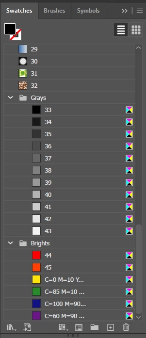

Hello!
With the following script, I want to rename a range of colors in my swatch from 1 to x.
var doc = app.activeDocument;
var swatches = doc.swatches;
var firstColorID = 16;
var lastColorIDfromEnd = 4;
RenameSwatchesColors(firstColorID, lastColorIDfromEnd);
function RenameSwatchesColors(firstID, lastID) {
    var swatchesLength = swatches.length;
    var newName = 1;
    for (var i = firstColorID; i < swatchesLength - lastColorIDfromEnd; i++) {
        alert(swatches[i].name);
        swatches[i].name = newName.toString();
        newName++;
If I only left the alert part that display the color name, everything is ok! The range is good, all colors within it are properly called.
When I assigned the name with "swatches[i].name = ", for some reason that I don't understand I got an error : "Exception has occured 8701. The name was not found".
But it was displayed with the alert! So it's basically an assignation problem, but why? I don't see any differences from others colors in the swatch. I have even tried to delete and recreate the problematic colors, but nothing changed.
Thank you if you have any clue...
Correct answer Sergey Osokin
An error may occur when changing the name if your swatch range contains the [Registration] color. I got error 8701 when I tried to assign a numeric name to [Registration]. But the letter name was assigned. Then I tried to undo the history and already [Registration] changed to a numeric name without any error.
But the [Registration] default color is at the position with index 1, and the test code renames colors starting at index 16This is an interesting case to study.
Sergey Osokin
Sergey OsokinCorrect answer
October 20, 2023
October 21, 2023
Yes you got a point, thank you for your answer. I still don't understand why some colors return an error (and not the others) but it's clearly due to the numeric values. I have noticed that I also get the error when 2 colors have the same name in the swatch. But at this point i'm 100% sure that all my colors have a unique name but still get this error.
Anyway, I change my assignation line by :
"swatches[i].name = "_" + newName.toString();"
And that works perfectly ! So it's best to avoid associating color names in swatch with numerical values 🙂
