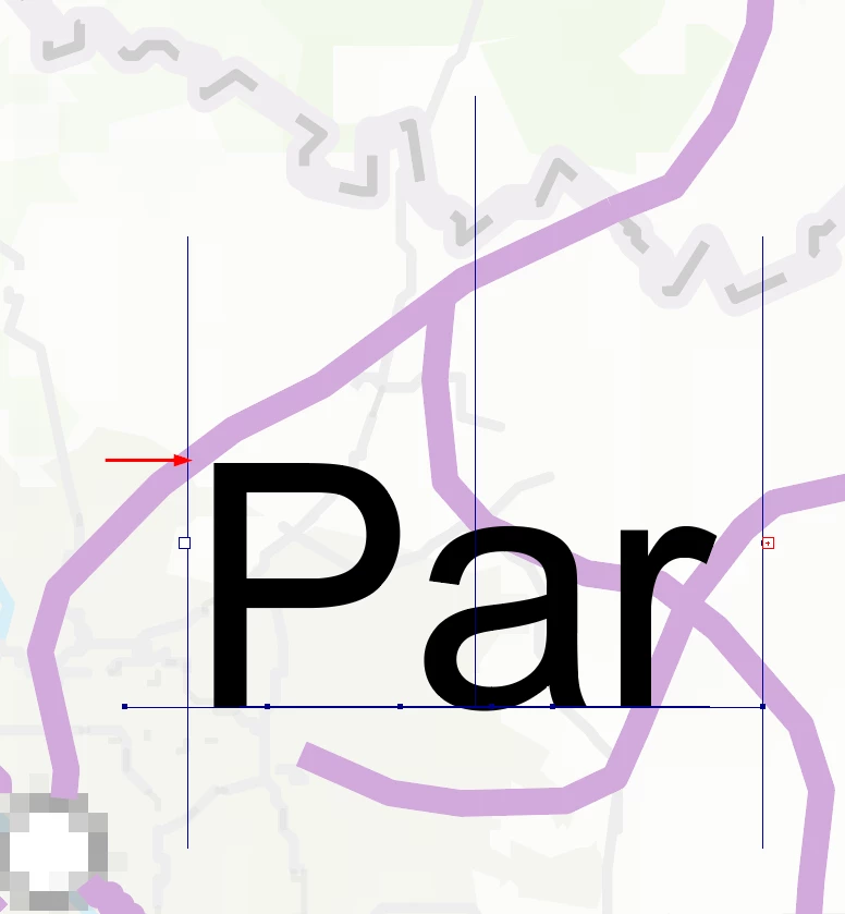

I increased the size of this text and now it is overset. I can't figure out how to make the text box grow, it only allows me to drag and distort the visible text.

That is pathtext. You need to make the path longer.
October 12, 2025

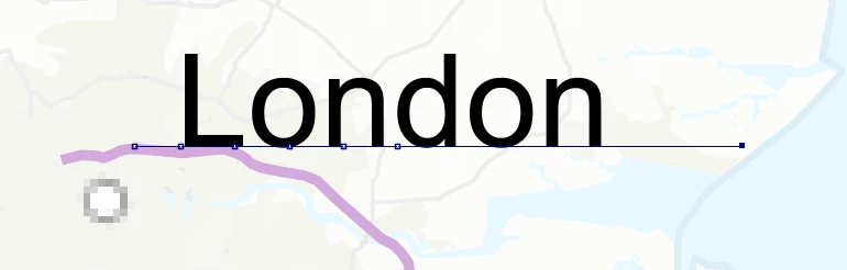

I was able to drag the outermost anchorpoint to extend the line. Thanks!
For anyone stuck I did have to move this line before I was able to drag the anchor point..

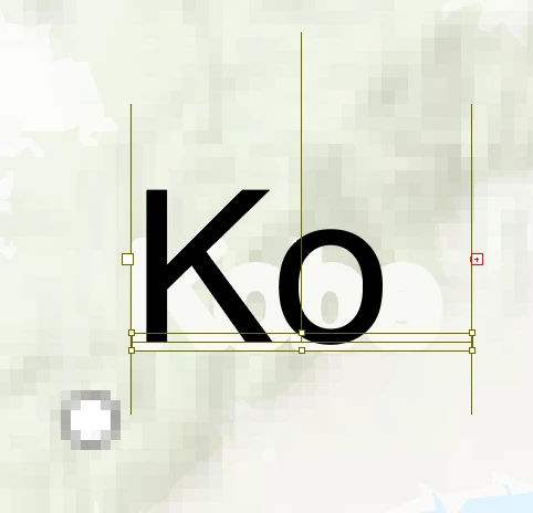

You can try: Type > Convert to Area Type
Edit: See Monika's answer, it is path text...
