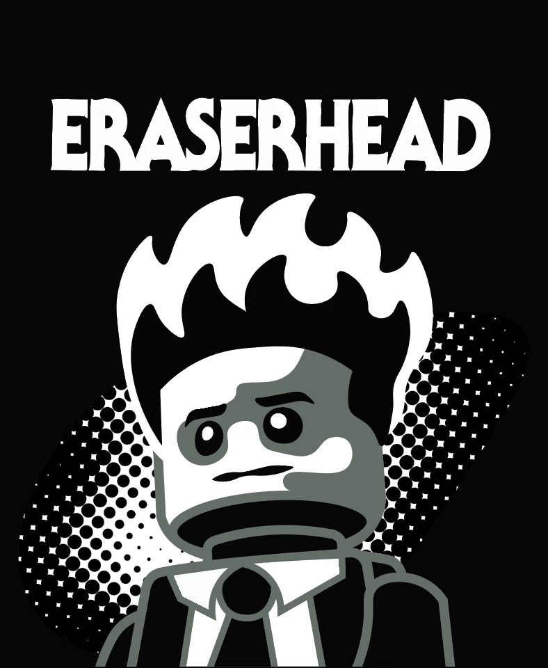

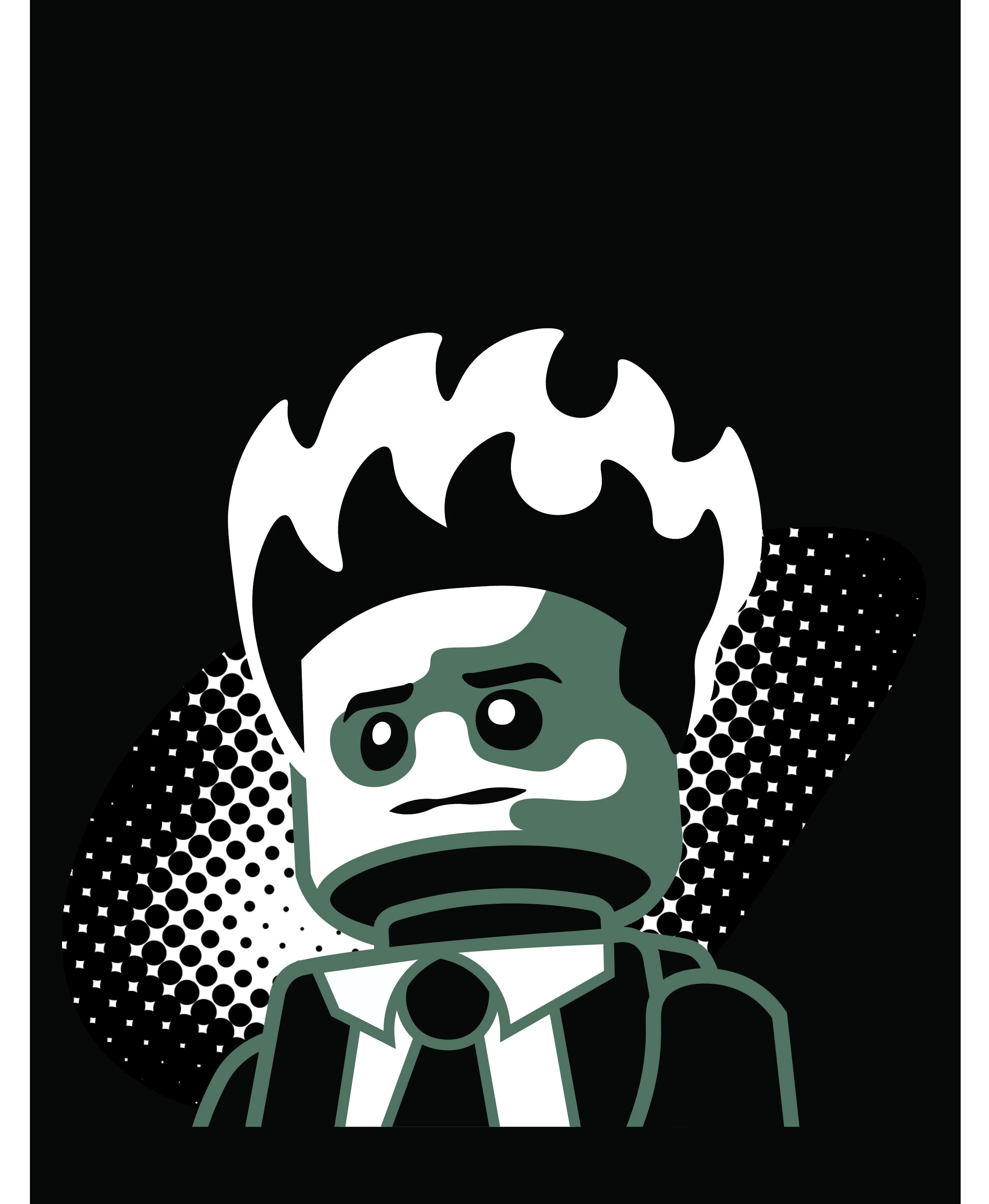

Here are the images I am working with. The screenshot shows how it looks in Illustrator. The jpg show how it looks when I export to jpg or pdf. You can see the effect goes from black to black in one image and gray to black in another. If I rasterize the layer, it selects all the space withing the bounding box and rasterizes it as white so the image looks like it's on a white field, which I don't want.
Hopefully this helps. I just can't figure out how to export it so that the colors remain consistent.
Dec 11, 2024 3:21 PM UTC
Very oddly, when I open the preview here, the jpg looks normal! I don't get it!
