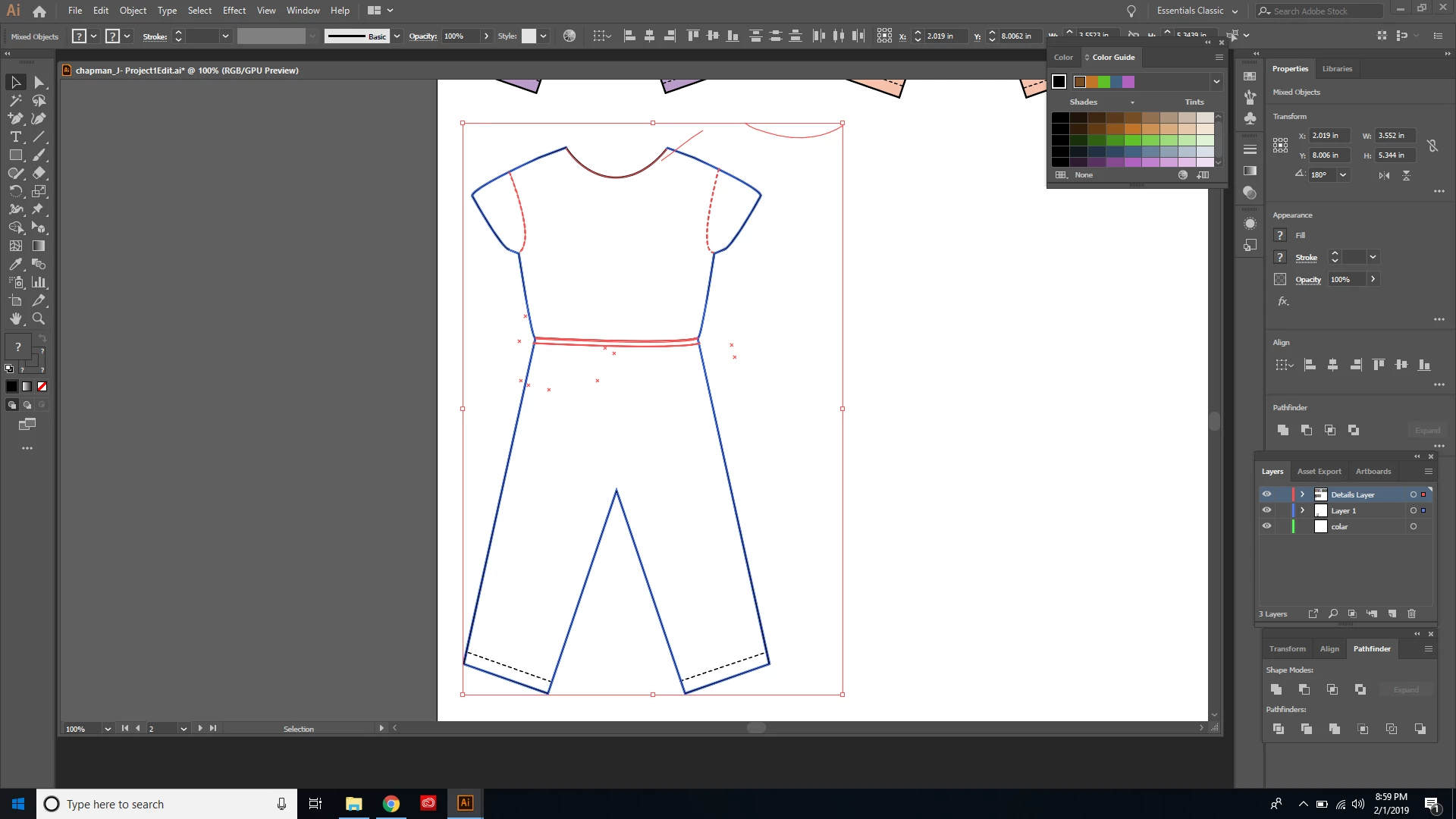

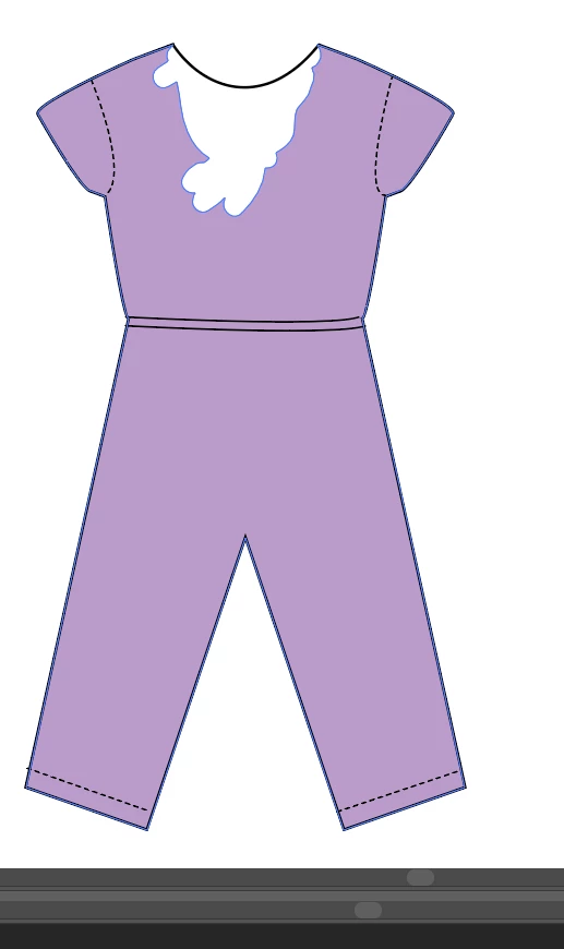

Hello!
I'm really new to illustrator and its been giving me so much difficulty I'm in a fashion class that requires us to create technical flats of garments. I was able to figure out how to color everything else, except for this one garment. To create the back of the garment I used the eraser tool to get rid of the neckline of the front and created a new neckline. Now when I try to color the back, it fills in everywhere else except for the part I erased to make the new neckline and I can't figure out how to fix it. Here is an idea of what it looks like: Does anyone know how to fix this?

Thanks to everyone that answered my question! I used the shapebuilder tool to delete the eraser tool path and no I cannot seem to fill the garment with color at all.

please, select only a garmet shape (blue line). What does the Control panel show in this case?

rcraighead
February 2, 2019
It's always helpful to include an expanded Layer panel as part of your screen capture.
I'm guessing your "Fill" and outline "Stroke" are not the same path. Open the Layer panel and expand the current Layer to see all the elements. See if you see the purple fill object. If so, do this:
  1. Select JUST the purple fill object using the hollow arrow (direct select Tool).
  2. Lock everything else by typing Shift+Option+Cmd+2
  3. Switch to "Outline" mode by typing Cmd+Y.
  4. This will allow you to select the section you want to delete using the "Lasso Selection" tool .
  5. Now you just need to redraw the area that's missing by using the Pen tool .
  6. Use the locked lines as a guide. Start by clicking on one of the end points and finish by clicking the other end point.
Your fill should be corrected.

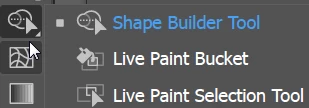

barbara_a7746676
February 2, 2019
Alternatively, as the last step, instead of using the Pathfinder panel, you could use the Shape Builder tool.
With the Shape Builder tool selected, hold down Alt or Option and click or drag over the parts you want to delete.

You need to delete those path segments the eraser created and then join it with the new path.

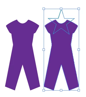

Instead of using the eraser, try this:
Draw one side and duplicate it.
Draw a shape on top of the side where you want a different neckline. The color of the shape doesn't matter, but it should have no fill color and it should have a stroke color and it should be on top of the garment.
Select the both garment and the neckline shape.
In the Pathfinder panel click the Minus Front icon.
