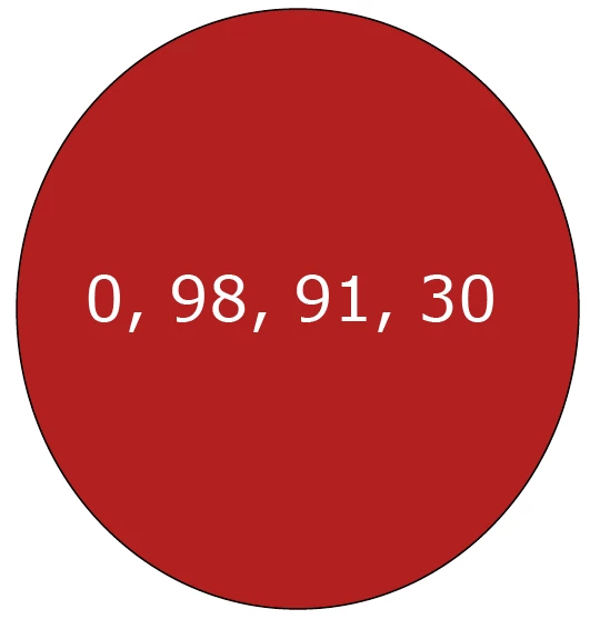

    here is a catalog with the colors you are looking for and it shows the cmyk values. it's not really ideal but it might get you close.
    http://issuu.com/gestiondecolor/docs/pantone-color-bridge-plus-coated
    the color you are looking for is 0,98,91,30
