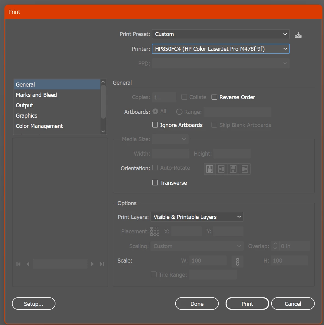

I am having multiple problems with Illustrator. among them;
When I click print in the print dialog box a window pops up saying 'Can't print the illustration. The Color Management settings are inconsistent.' I have tried resetting preferences to no effect. This seems to be an issue with newly created documents. Documents from a few weeks back will print though on opening I get various messages about incompatible color spaces. Never sure which option to choose.
Illustrator v 24.0.3
iMac OS 10.15.3 (retina 4K, 21.5 inch 2017)

In my case, this happens when AI decides not to use my default printer.  It grabs Adobe Postscrpit File as my printer.  Then when I change it to the correct printer, I can't change most of the settings (copies/rotate/scaling) I get this error.  Then I go print it again my default printer is actually used as the default and everything works.  So, why is AI choosing Postscript File?  I have never, in 30 years needed a PS file.  How do I stop it from even being an option?

August 10, 2022
I just had the same problem with my printer, and after following the advice on this page (which didn't actually help ... sorry) I started just changing settings and seeing what happens.  I've found out that the Printer Profile which is under Colour Handling in the print dialogue box was set to the wrong setting.  As soon as I changed it to Adobe RGB (1998) my printer worked fine.  It was on sRGB IEC61966-2.1.  Maybe this will work for others.
