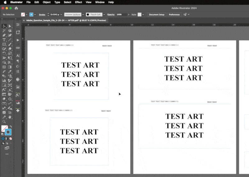

Yes! Attached is a sample file. The blue rectangles is what we need: L", W", total SQ IN
Is it possible to add these values outside of each rectangle? If not, having them somewhere in the artfile (permenantly) would be best!
jduncan
May 29, 2024
Okay, I have included a script below that should give you what you want. I have also included the screen recording of it working and a copy of your sample file after running the script.
First please note that you have the die paths inside of a group by themselves and the inside of a larger group that includes some "TEST" text. You mentioned above that you would select the die paths before running the script so that is how I set it up... But, since the die paths are in separate groups I selected one die path using the Direct Selection Tool, then used the menu command Select > Same > Stroke Color to get all of the die paths. You can see the process in the screen recording. If all of your files are organized and grouped this way, the script should work just fine, if not, some adjustments will need to be made, as the script only works on the first pathItem in each selected die group.
Once you have your selection, just run the script below and a text frame with the die size info will be placed at the top left of each die path. All text is placed on a separate "non-printable" layer, so you can keep or discard however you please. You can also rerun the script and it will remove any previous/old information before recalculating.
Let me know if you have any questions. Cheers!
