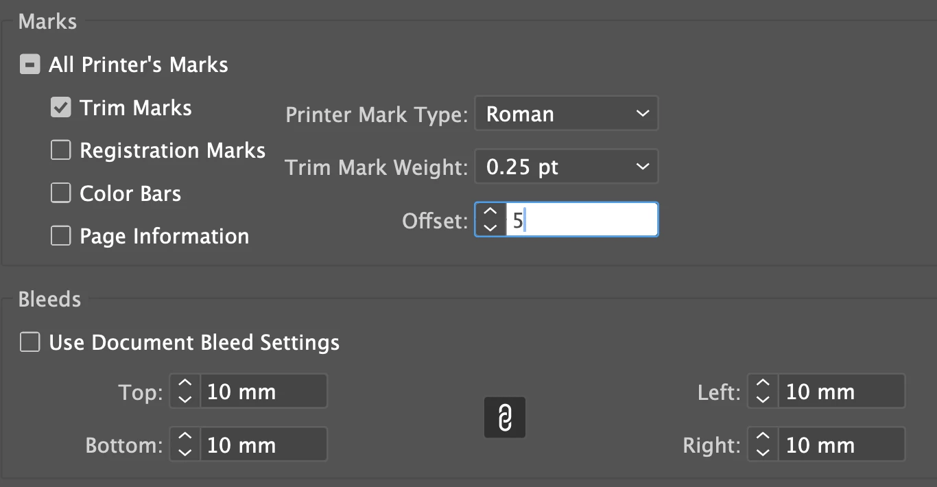

I think, as the slug is unavailable, just place the information out of the bleed area as shown in the screenshot and while exporting, set the bleed to cover the info whatever outside the bleed. (I use a document bleed size of 5mm and in export I set the bleed to 10mm).

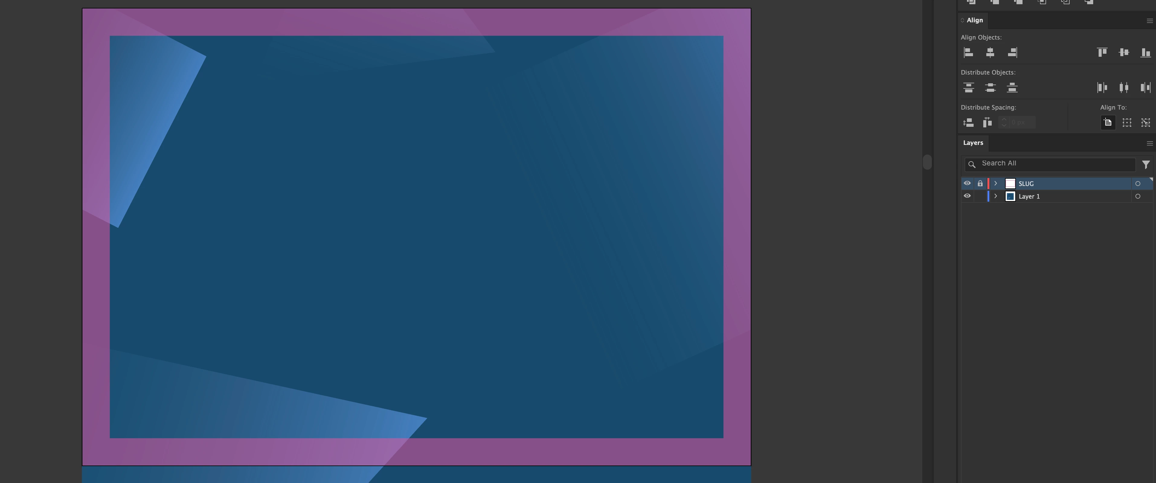

August 16, 2023
Since there is no official way what I usually do is just create a shape that is the width of the slug I need, and copy that shape so it is on all sides of the artboard. Group these shapes together and lower the opacity to 80% and lock that layer. Name the layer SLUG. When you go to export or save out the art just simply turn off the SLUG layer.
