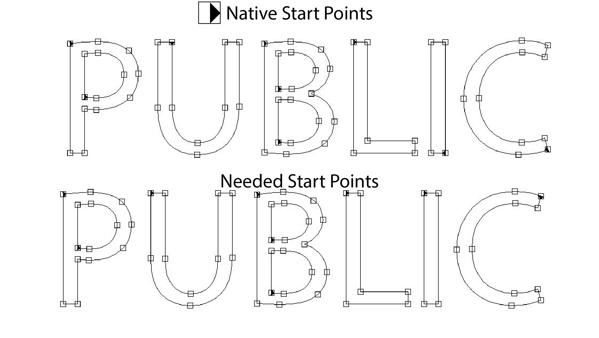

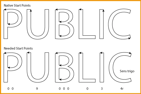

Is there an easy way to identify the Starting Anchors of Letters that have been Outlined?   The only thing I can find is to delete a line segment and replace it, but that is really impractical when working with 100's of letters.
I'd really love to be able to automatically set the Starting Anchor to the Highest angle Anchor of each letter.

Soit l’exemple du texte vectorisé PUBLIC, il s’agit d’un groupe composé de six tracés transparents  (comprenant neuf tracés sans fond, contour noir 1pt),
certains tracés sont en sens horaire et d’autres en sens trigo.

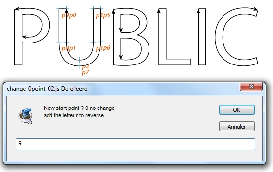

1 Sélectionnez le groupe.

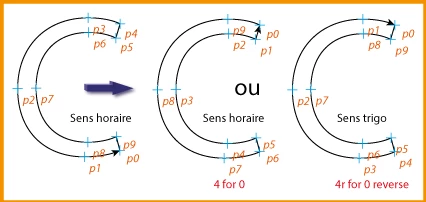

2 Lancez le script.
3 Affichage des informations sur l’ordre des points du premier tracé (pathItem).
4 Saisie du nouveau point d’entrée , 0 si pas de changement, ajouter la lettre r si inversion du sens de parcours.
          pour la lettre U je choisi 9 comme point de départ.
5 Retrait des informations.

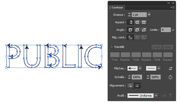

Un moyen simple pour identifier le point de départ d'un tracé fermé est d'utiliser Contour / flèche début
A simple way to identify the starting point of a closed path is to use stroke/ arrow start

Sorry, I think I may have used the wrong Terms.  I would need the Priority to be
- First a Corner Point
- Second a Connector Point
- Last a Smooth Point
  • Corner Points: Connect straight line segments to straight line segments and do not need Bezier handles.
    Corner Anchor Points
  • Smooth Points: Line segments that join in smooth, continuous curves, two, opposing Bezier handles will extend from the anchor point which is used to control the bend. The handles on a smooth anchor point are reciprocal and always stay in alignment. Here's a three-anchor-point sine wave:
    Smooth Anchor Points
  • Connector Points: Connector points are used to connect straight line segments to curved ones, or to connect curved line segments that meet at an angle.
    Connector Anchor Point
Thank you!

Ok the point types are fine, how do we know that the point you want selected (remapped to be the start point rather) on the "U" is supposed to be the top left one vs the top right one (talking about the points on the top left stem)?
If the rule for this could be conditionally assessed by the script then the next step would be to redraw the paths with the re-ordered point arrays, a matter in itself.
