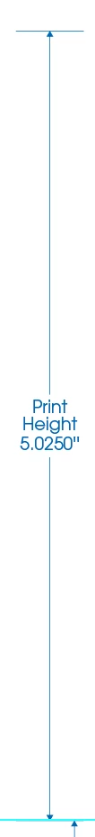

At my place of work we use a lot of templates.  I am part of a team responsible for creating and updating these templates.  Most of them show distances between to points that have a line w a measurement label.  My question is as follows.
If you have a line and center align a text box/object to it, then later need to extend that line but still want the text box/object to be center aligned to it is there a way to lock that alignment so it will move as the line extends?
I know if you extend the line both ways symmetrically you don't have to worry about it, but that is not always the case I am set with.  Most of the time with a new template I just need to make a current template taller so I just direct select the top portion and move every thing up as needed.  Unfortunately, after that I then have to reselect the measurement lines and realign my text box measurement label.  I didn't know if there is a way to keep that track the centering when I extend the line up?  I am trying to avoid stretching also because that has its own fine tune adjustments after the fact.

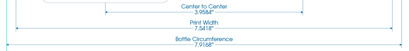

Thanks everyone. There are a lot of good suggestions here.  I never thought about using a Text on Path approach. The only issue with the way we have most things labeled is to keep the text horizontal on a vertical path.  Right now its just setup with multiple objects that if the line needs to be extended the objects for the text have to be manually realigned.  With photo example of the areas of what I was hoping to find a more automated solution to.

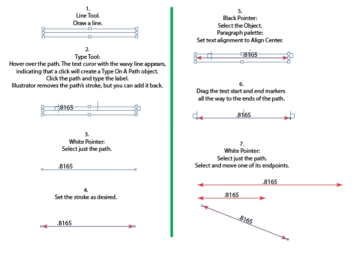

JETalmage
October 6, 2017
Create a pathType object (Text On A Path):
(Or, just use a program which provides dimension lines with measures that auto-update when you change the width of the path.)
