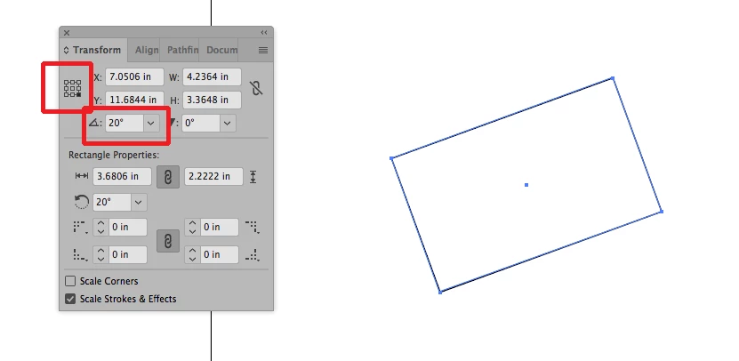

    You can use the Transform Panel to numerically rotate around a designated point of an object. See Screen shot:
    With an object selected click on the reference point icon the point that you wish to rotate the object from and put a rotation value into the angle field as highlighted above. Your object will then rotate from the point that corresponds to the reference icon.
