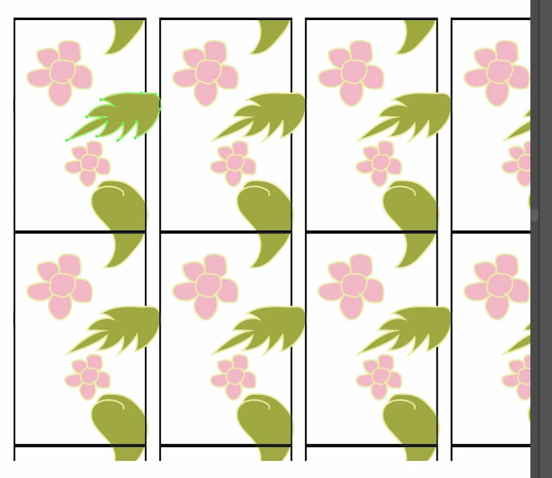

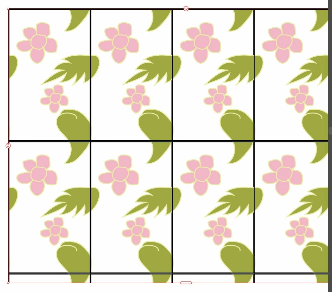

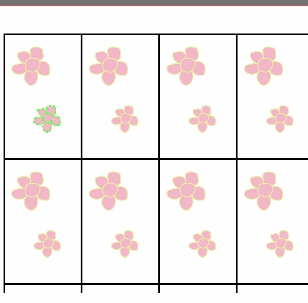

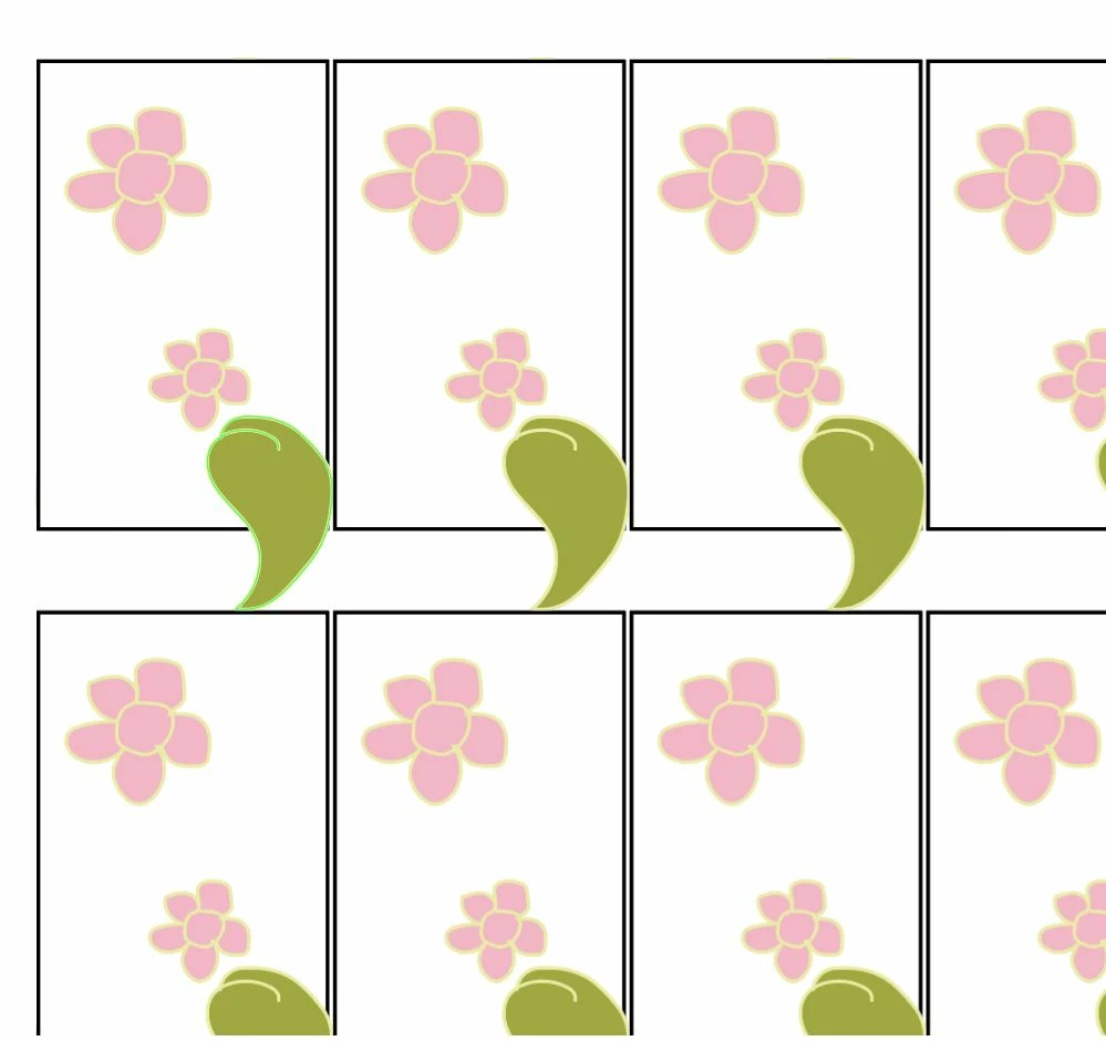

Attached is an example/sample file and screenshots of what I mean. As you can see in the example, I am basing a pattern around a black-rectangle as a guide for my pattern spacing, but I want to be able to draw in new overlapping elements (e.g. leaves etc) that connect between the repeats, without the repeats moving apart everytime something extends beyond the rectangle; as seen in the example pictures. Attached is also a copy of a Willliam Morris pattern design, so you can see the kind of pattern that can only be achieved through being able to draw over the edges of a rectangle.

Note, I tried to attach the .ai file, but it would not let me attach that file type, hopefully you understand the issue from the screenshots, cheers
