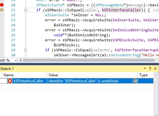

  1. The if statement at line 21 initially gives back false, probably since kSPInterfaceCaller is undefined or empty.

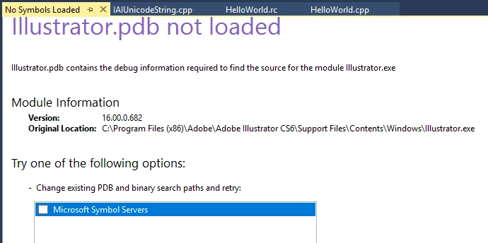

  2. The end if is reached and gives the above message: "Illustrator.pdb not loaded".

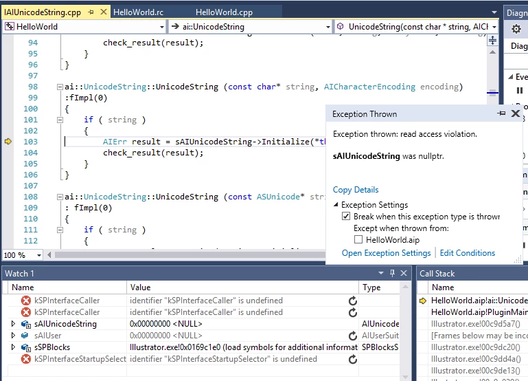

  3. The if condition executes once more and this time returns true. However, the sAIUnicodeString variable still holds NULL, perhaps because sSPBasic->AcquireSuite() failed.
  4. Since sAIUnicodeString is NULL, a Read Access Violation is thrown.

  1. The entry point is called many, many times over the life of a plugin depending on how complex the plugin is. I very much doubt kSPInterfaceCaller is empty or undefined because it's a constant defined in the SDK. Most likely, caller is something else. You should be able to see it's value in the debugger (You should use the Autos window BTW, so you don't have to type out the variables to watch every time).
  2. That's because you don't have a PDB for Illustrator; i.e., you didn't build it, so you can't see inside any of the SDK calls.
  3. You're probably correct on this count. To verify, what is the error variable's value after it attempts the AcquireSuite call for sAIUnicodeString?
If the value is zero, it's claiming it worked, but we both know that's probably not what you'll find. The value may point to the reason, as the code can be very illuminating, if we're lucky.
August 11, 2017
The error number returned is 1394689636 for these 2 calls:
error = sSPBasic->AcquireSuite(kAIUserSuite, kAIUserSuiteVersion, (const void**)
&sAIUser);
error = sSPBasic->AcquireSuite(kAIUnicodeStringSuite, kAIUnicodeStringSuiteVersion, (const
void**)&sAIUnicodeString);
and 0 for this call:
error = sSPBasic->AcquireSuite(kSPBlocksSuite, kSPBlocksSuiteVersion, (const void**)
&sSPBlocks);
which make sense since both sAIUser and sAIUnicodeString hold null after the call, whereas sSPBlocks holds a non-null value. So regarding the above error, I found this thread:
AICSXSExtensionSuite error 1394689636
I'm using Adobe Illustrator version 16.0.0 (both 32 and 64 bit). Could this version be the cause, if so is there a workaround?
Thanks.
