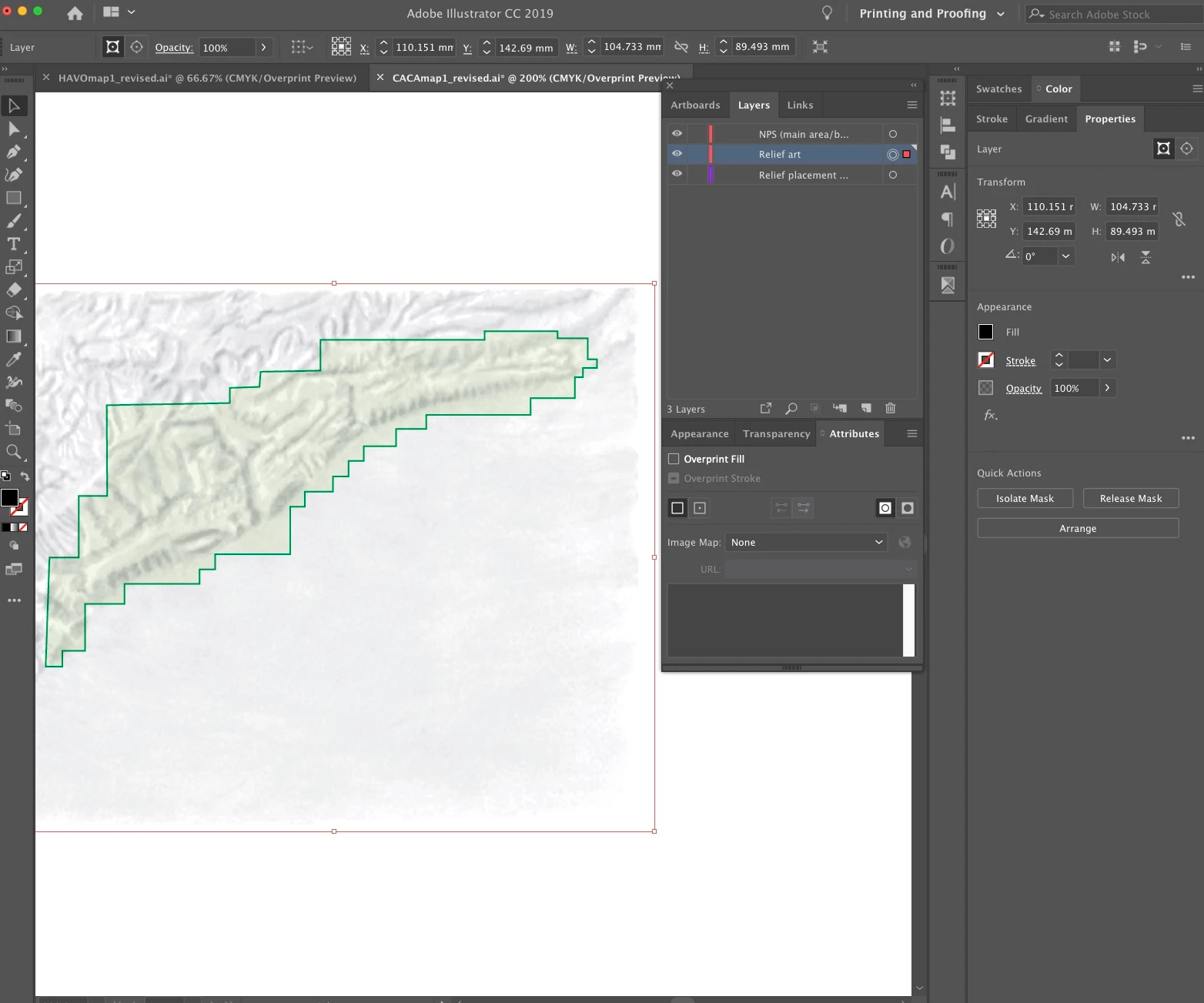

I retrieved a map with a relief layer that is overprinted. However, I cannot figure out how the person who created it made that relief layer overprint. If I select the relief object, I see that "Overprint Fill" is not checked in the "Attributes" panel, and does not seem to have any effect. My question is how do I locate the switch that turns overprint on/off for that object? In case looking at the file would be useful, it is here: http://terragalleria.com/private/CACAmap1_revised.ai
Conversely, I added a relief layer to another map, and when check the "Overprint Fill" box, no overprinting happens (overprint preview is on):
The file is here: http://terragalleria.com/private/VOYAmap1_revised.ai
Thanks

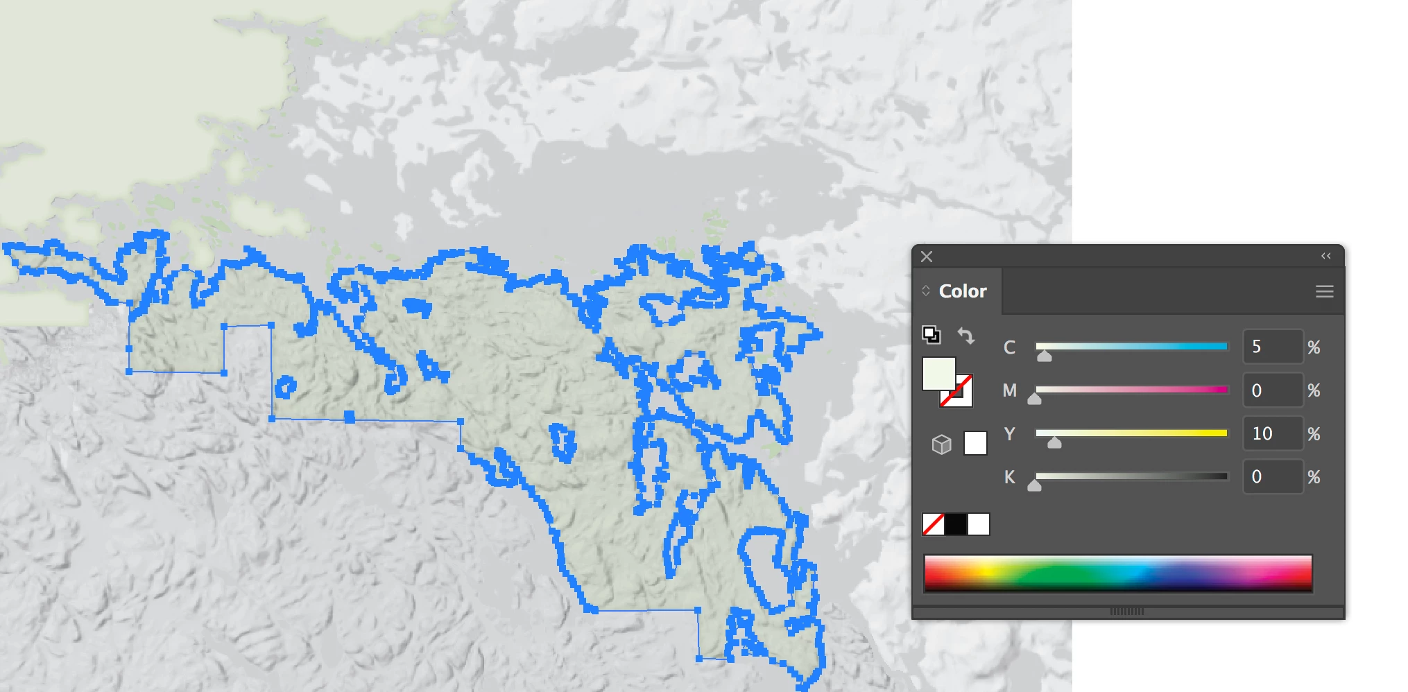

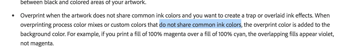

    Correct answer Mike_Gondek10189183
    Overprint does not work when you have like inks between  2 items. So you fill of 5c 10y 8k will not overprint your embedded image made of black
    I took the black tint on the selected fill as an exam ple, and you can see that overprints now.
    How to use overprinting in Illustrator

    Mike_Gondek10189183
    Mike_Gondek10189183Community ExpertCorrect answer
    February 12, 2019
    I stopped using attributes overprints ever since the transparency multiply came out, as for me is quicker and more efficient.
    I could not downlaod the links in your post #11.

    The first link in your post does work for me.
    The light green path is overprinting (both fill and stroke). Not quite sure what you are missing here.
    The second link does not work, as already stated.

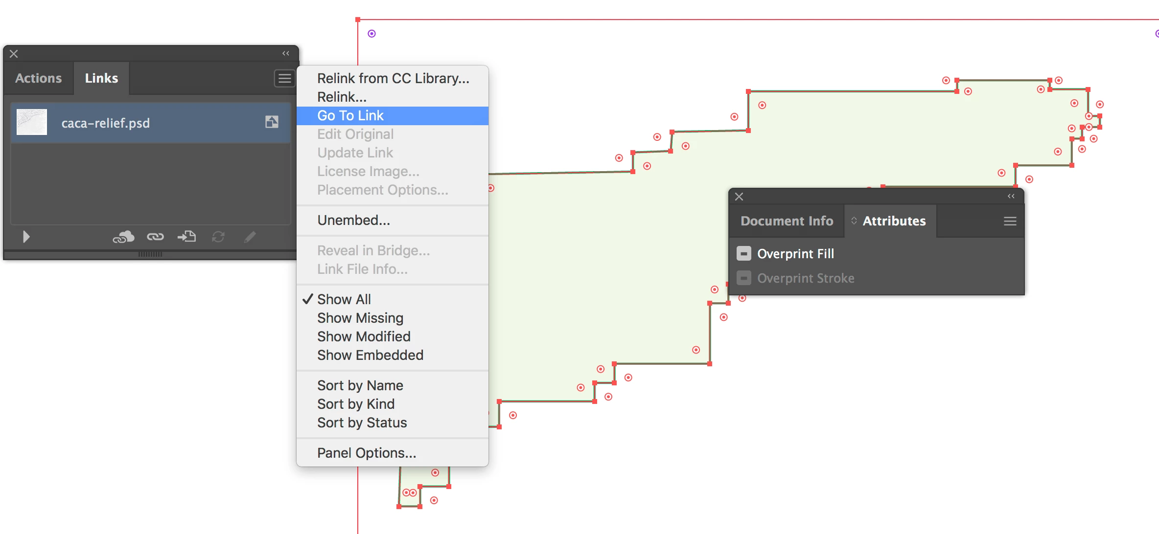

    Mike_Gondek10189183
    February 11, 2019
    Images get in the way of this, so links panel >> go to link, then hide he linked image(s).
    Select all, turn off the overprint on the fill
    Select any stroke, select similar, then turn off the stroke. You can then hide that, and proof ntohign is left that has a overptin attribute set.
