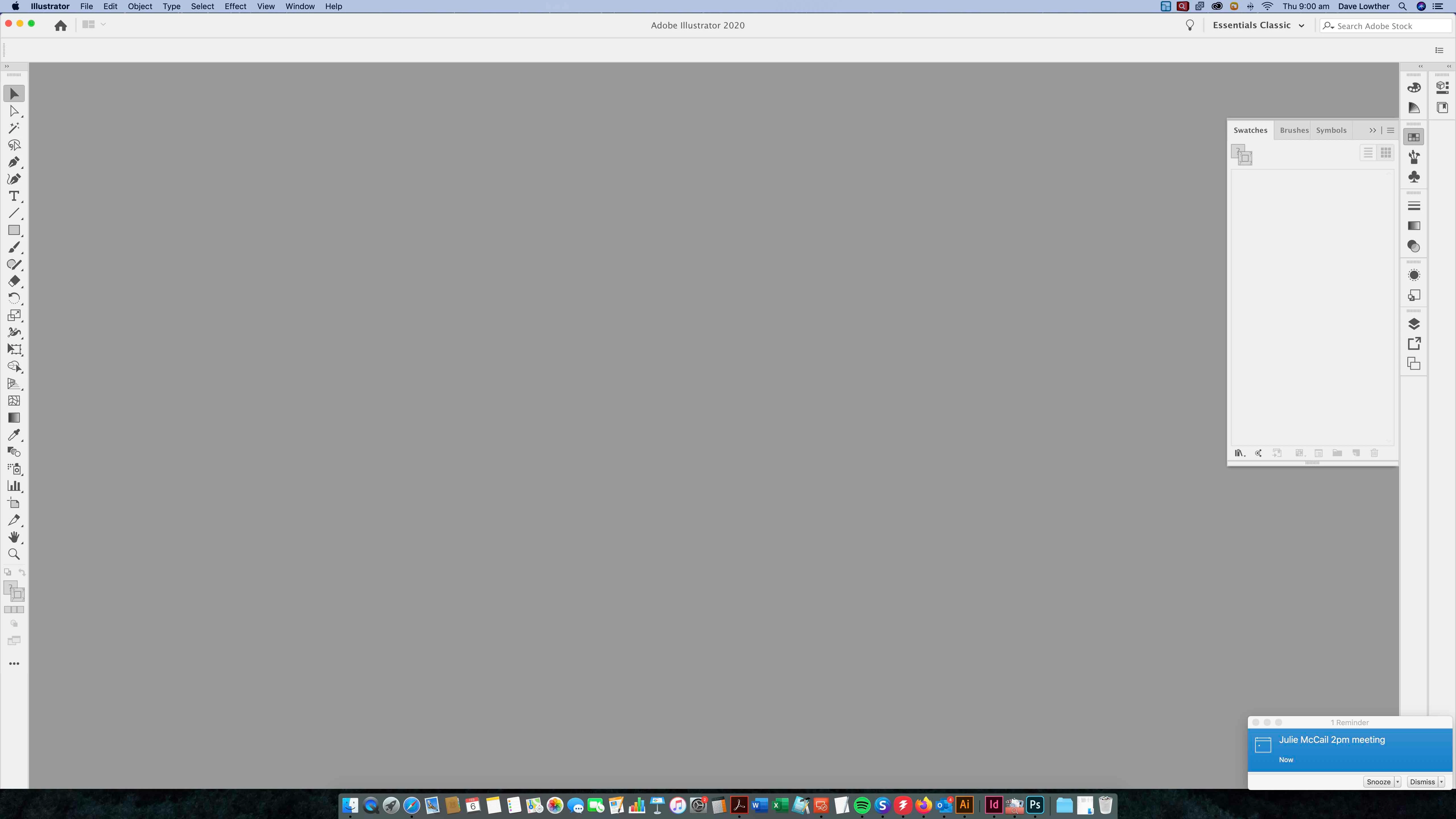

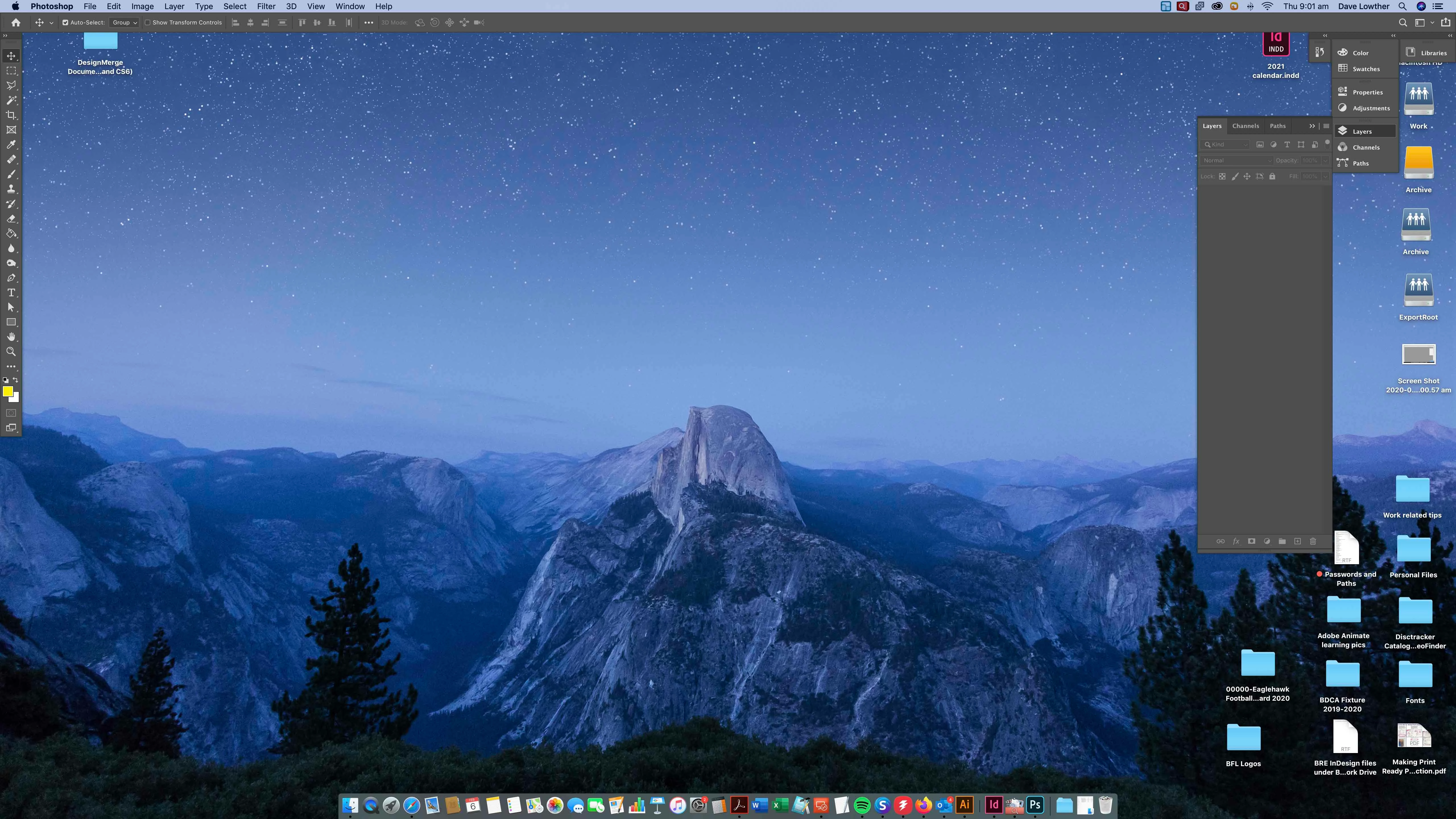

Hi there,
Does anybody know why after turning off "Show the home screen when no documents are open" you can't see the desktop anymore? There is a grey screen instead that looks to be an empty document which appears every time you use Alt Tab to go back into Illustrator from other programs. The latest Photoshop and InDesign don't do this so wondering if there is a setting I'm not seeing. Hope you can help? 🙂
Dave
Correct answer Ton Frederiks
Did you try to turn off the Application frame?
Window menu > Application Frame
Ton Frederiks
Ton FrederiksCommunity ExpertCorrect answer
February 5, 2020
davidl81403367
February 5, 2020
Thanks, Ton! I appreciate it stacks it was as annoying as driving behind a caravan! Much appreciated 🙂
