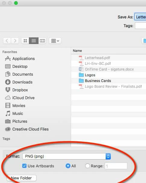

I am very upset with the fact that I can no longer select the Artboards in Illustrator when exporting FILES!
The selection is now grayed out!
I recently had to upgrade to OSX Sierra because of a scanner issue with PhotoShop and now I have been screwed using Illustrator!

    It's a problem with Sierra. Couple of things to try. Narrow the dialog window of try using the toggle arrow at the right of the Save As: dropdown box. It should give you a different dialog which should have the Use Artboards option.

    I was having this problem too (Artboard option greyed out on Save As dialog box) but figured this out
    (I am using latest CC Illustrator on Windows)
    I found that under File > Save As the defaults to use .AI and for whatever reason .AI format isnt supported but if you switch File Type it'll work
    I found PDF doesnt actually export individual files (makes each artboard its own page), but SVG does
    So basically its a workaround but you can export to EPS/PDF/SVG this way, just not to .AI

    If you only have 1 artboard I found a work around.
    Create another artboard, and then in the dialogue box it will be auto selected on artboards. You can then also change the range of artboards that are exported to get exactly what you need.

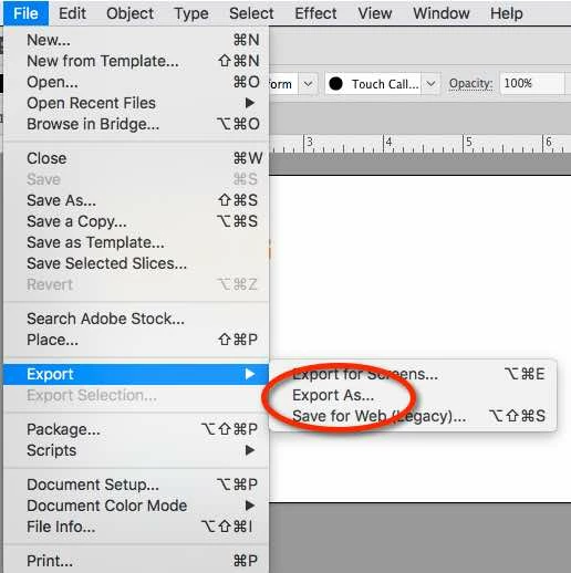

    I am using a late 2011 macbook pro with Sierra and Ai CC 17
    Here is how to export Artboards:

    I guess you did not read the part where I plainly stated that the Artboards area IS NOT available to me and is GRAYED out, I.E, it will not let me select same and 'Use Artboards' does not even show up anymore!!
    I had been using this feature excessively BEFORE I upgraded to Sierra!
