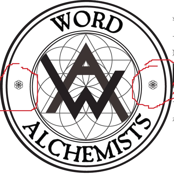

Hi all,
i want to ensure that the small geo icons (in red) are perfectly centred within the border  ring(the bit that also happens to have the text in it).
I cant figure how to do this as aligning to the circle obviously results in them being put middle of the circle rather than the middle of the border.
They are probably pretty close to being centred in the border just from me doing by sight but they are not quite there. HelP!

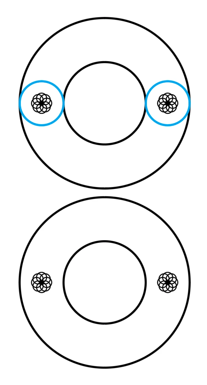

This is another way, as there can be several solutions with the same result.
-I usually draw a blue circle that is the exact width of the inner and outer circle space and align horizontally and vertically with the icon. Group the icon and blue circle.
-Next, I select both black circles and the blue circle icon group, and align everything to horizontal center. Then I take my blue circle and icon, and with snap to point turned on under the view menu, I will snap the left point in the blue circle shape to the outermost black circle. Then I will duplicate the blue circle and icon to the opposite side (snapping tthe right point of the blue circle to the far right of the black outer circle point). Finally, I select just the blue circles and delete them.
