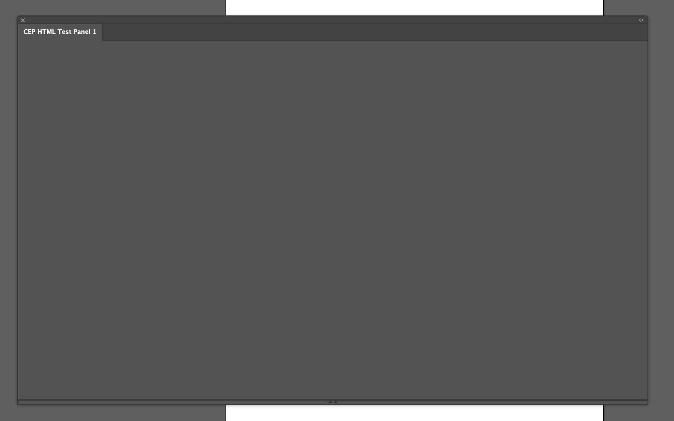

Every CEP panel I open is blank in Illustrator 29.5. They are fine if I open them in 29.4. It is behaving as if PlayerDebugMode is set to 0, but that's not the case. What's going on?

@Adam2230367211bg - One more thing that you can try is to set the PlayerDebugMode to 1 for CSXS.12
defaults write com.adobe.CSXS.12 PlayerDebugMode 1

Check the logs it might have some entries for what is causing the trouble. If you are using an unsigned extension and the same was loading on 29.4 then nothing more would be needed to laod it on 29.5. So the first step would be to check the logs. For the log location check the documentation linked below

Thanks Manan. Checking the logs made me notice that there were logs for CSXS.12 and that I had to use that verison instead of that one I have been using (CSXS.11).

This was it, thanks!
