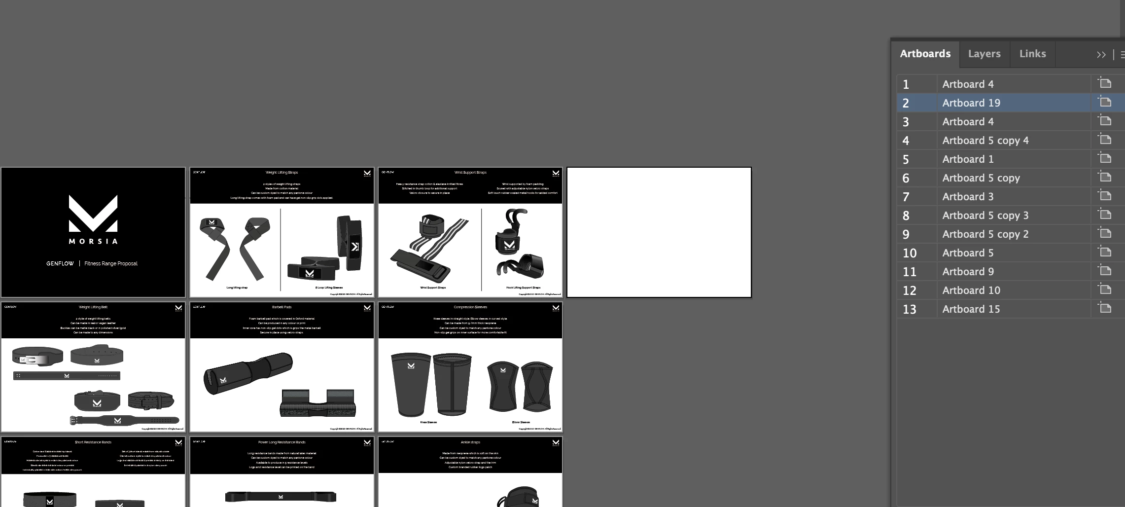

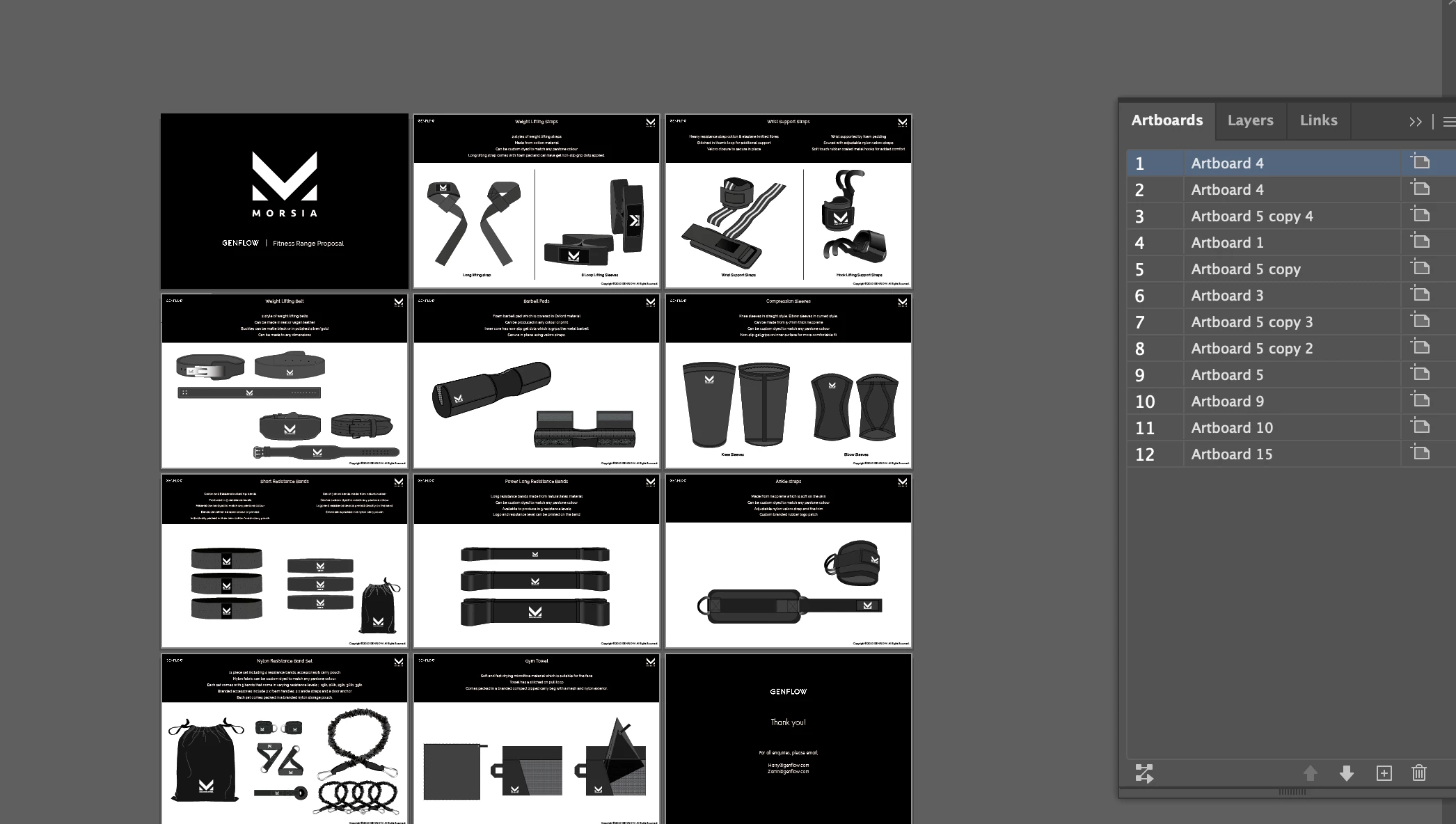

I am using Illustrator 2021 and i always had this issue that made my work life so hard as I had to create artboards after I already had 10 of them and needed to add some in between. But I JUST found out the solution.
If you want to add artboards and have them placed between some existed artboards here's what I found out works:
Open artboard panel and rearrange your artboard so that you know exactly in what order they will be exported.
The number you see at the start of the layer names are the order number (right now I have 1,2,3...12)
Now I want to add an artboard after my no1 and to be exported as no2. Therefore, if I click my first artboard layer and click on the + icon (to add the layer after my first one in order) it will add the new artboard as my second one.

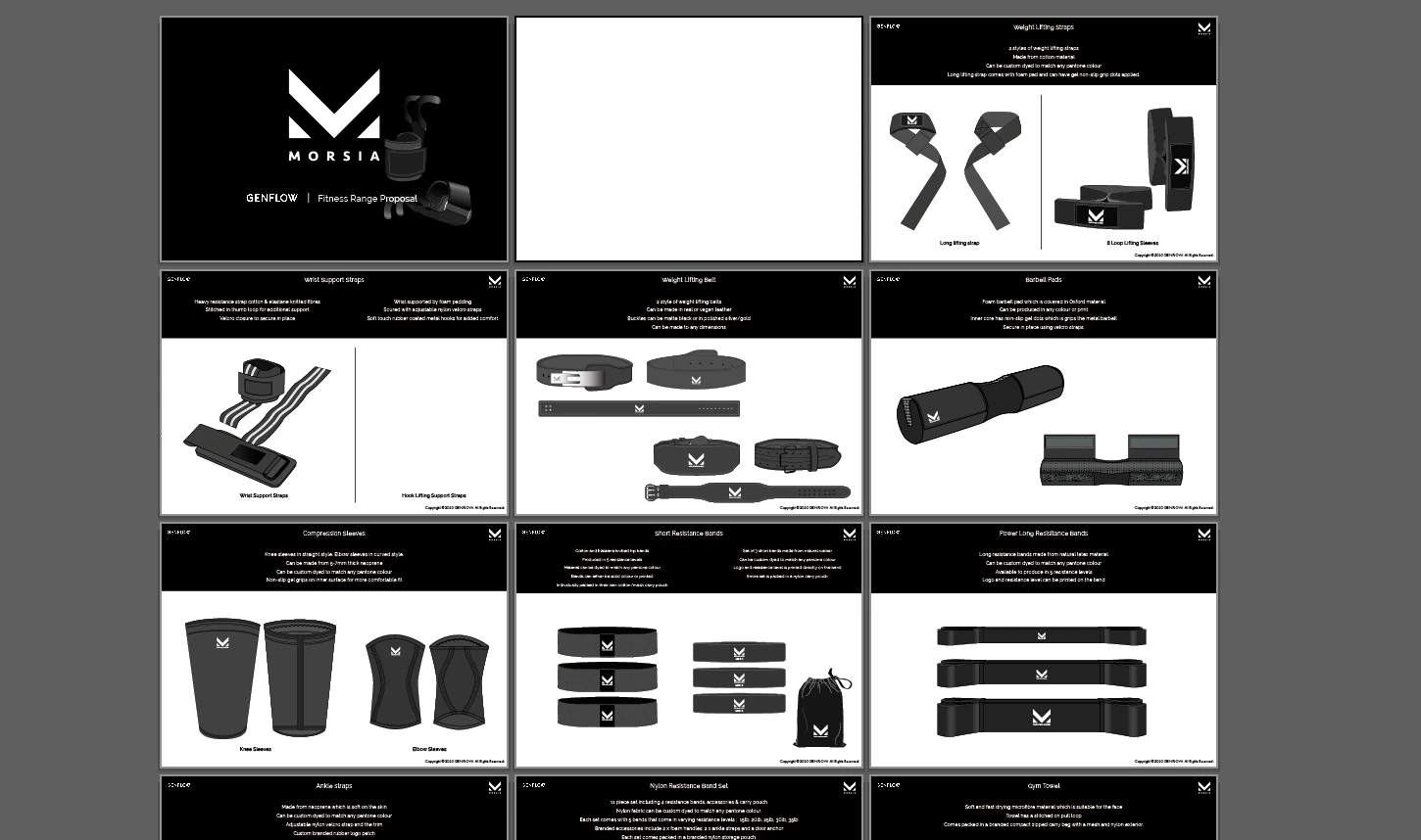

Now you will see on y artboard layers that the artboard that has been created (Artboard 19) is placed at the end of my artboards on the screen but it is nubered as second in order. To confirm that we have our artboard in the order we want it, we can click REARRANGE again and see:
It's placed second in order, as I wanted it to be.

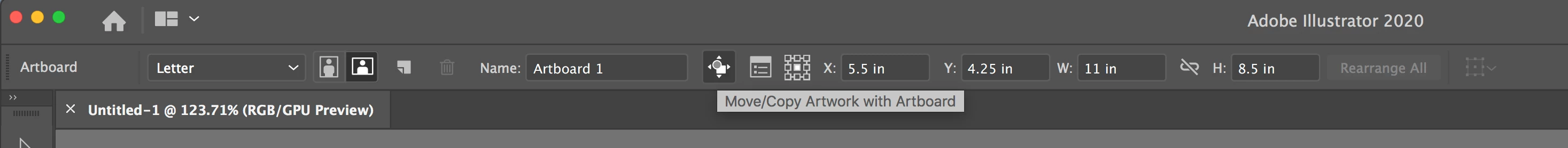

With the Artboard Tool selected, go to the top where you'll see an icon of a gray circle on the top right of a white square with arrows around it called "Move/Copy Artwork with Artboard" turn that off and you'll be able to rearrange your artboards without moving your artwork.
CarlosCanto
March 6, 2020
thanks for your answer but you're a bit late to the party, the question was asked 10 years ago. At that time there was no artboard panel, re-arranging artboards was possible but it was a royal pain.

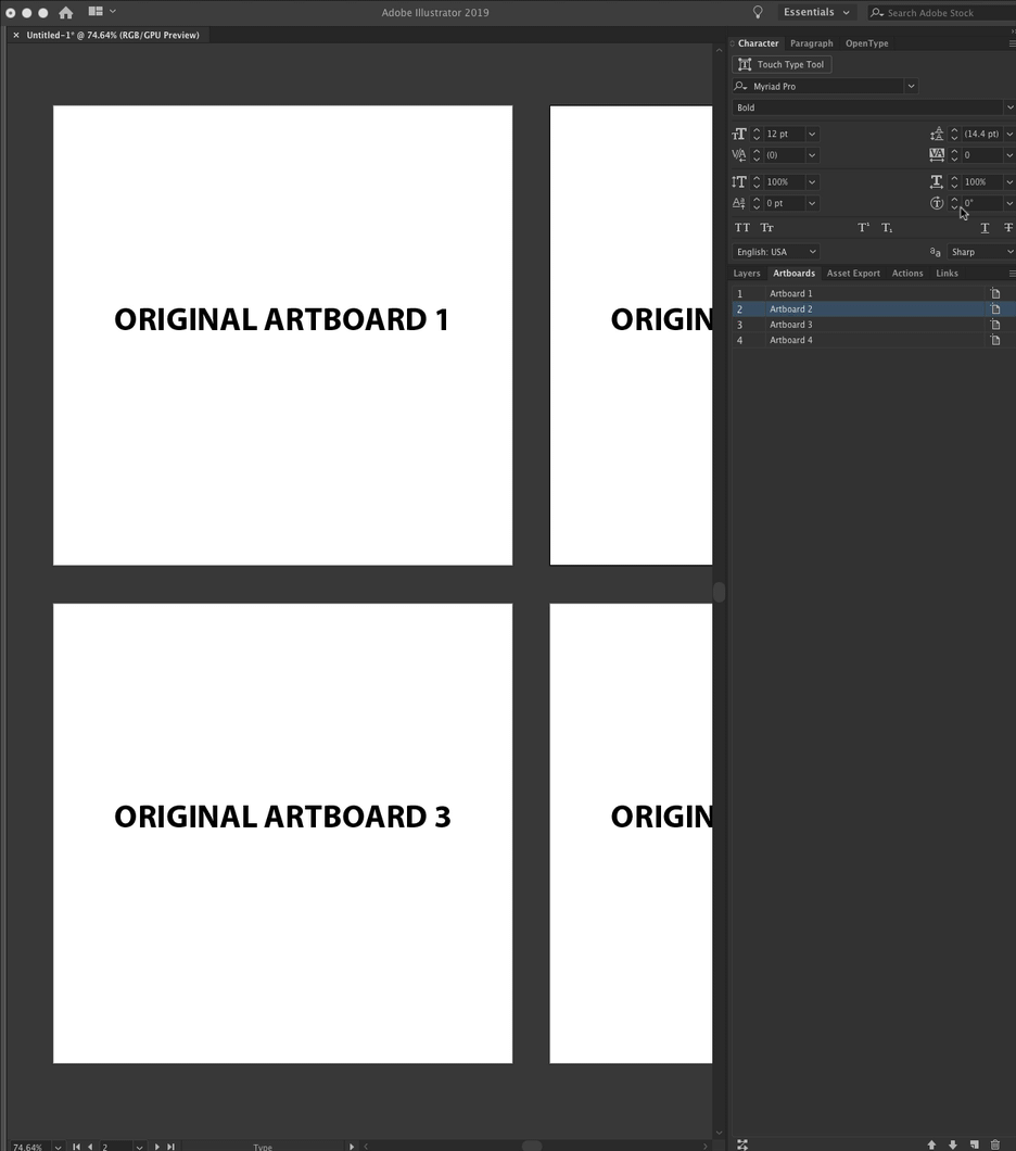

Hey! This is how I did it in CS6.
  1. Menu>Window>Artboards
  2. Select Artboard
  3. Click UP or DOWN arrow
I hope this works in all the previouse versions of Illustrator!

Open the artboards panel, drag the artboards in the order you want them to be. They will keep the same artboard # but will export in the order you place them and won't move or rearrange the artboards in your file.
