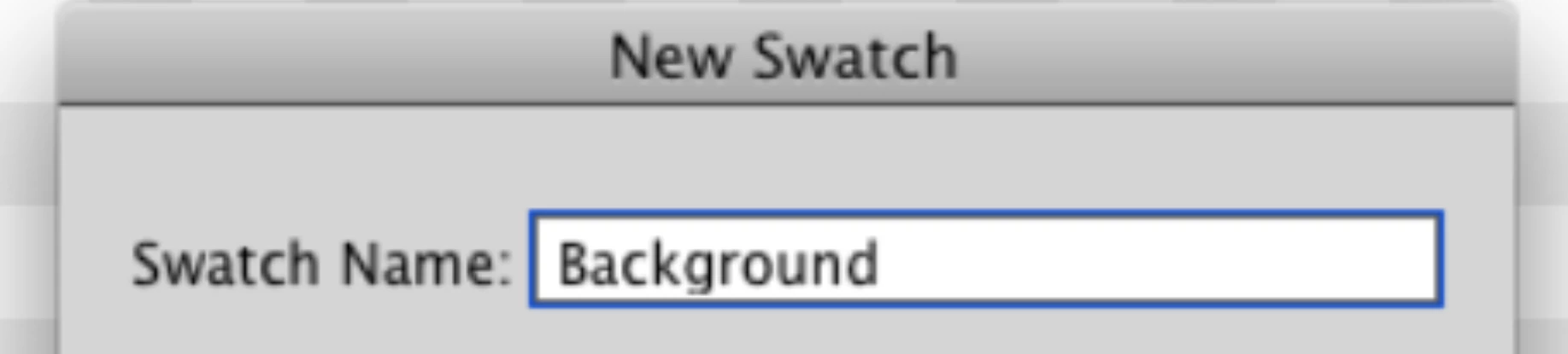

I need a Script to change swatch names without Error Message when it doesn't find a swatch.
