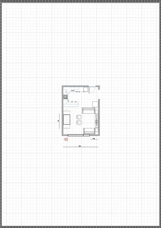

I have an architectural floor plan with each room on an A4 Artboard scaled at 1 to 100.
  1. I want to change the scale to 1 to 50 so each room fills the A4 artboard. How do I do this?
  2. Once I have the correct scale to fill the artboard, how do I print just the one artboard at a time?
Please see the attached screen capture of the living room artboard
I look forward to your answer.
Jim
Correct answer Jacob Bugge
Jim,
Concerning 1: As I (mis)understand it, you can just select the entire artwork on the Artboard, then Object>Transform>Scale uniformly bt 200%.
Or, with the centre Reference Point ticked in the Transform panel, just add *2 to the W or H box and hold Ctrl and press Enter.

Jim,
