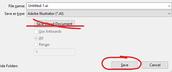

Mike_Gondek10189183
July 5, 2022
I have never had this issue in over 30 years on my computer or the ones I service. Does not mean is impossibe but rare. Might you be new to Illustrator and possibly have a cloud version and also one on your drive and are mixing up both of them?
VincentHGAuthor
July 9, 2022
No, definitely not saving the files to the cloud. And I've been using Freehand and Illustrator for around 15 years myself, about 9 on Freehand and then about 6 on Illustrator, and have never seen anything like this either. But I was always using an installed software on my Mac - no internet connection even required. This is the first time I've used a cloud version.
