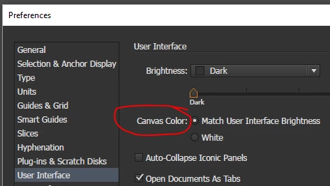

    How can i change the canvas color?
    PrepressPro1
    November 3, 2016
    As shown in the previous screen shot, there is a Canvas but the UI limits your ability to color this to Light, Med Light, Med Dark and Dark. There is a Custom in the Pull Down menu but it seems to be greyed out and unselectable. It seems the Canvas is limited to four levels of monochromatic brightness.

    August 6, 2015
    I think I can help.
    I just went to View> Overprint Preview and unchecked it (it was turned on) and it turned my canvas color back to the gray that I like.
    If you want it to be white, make sure 'Overprint Preview' is checked and turned on.

    aTomician
    March 10, 2016
    Darleeng,
    not sure what you are trying to achieve exactly, but you can change the shading of the whole program by going to Edit > Preferences > User Interface
    This will only change the way it looks and feels though.
    If you actually want to change the background colour of your artwork, I suggest you create a box (shortcut key = M) and add it below all the other layers and fill it however you would like.
