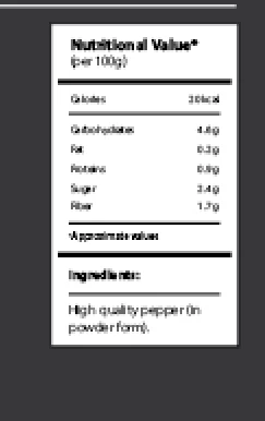

It's actually a print file for package design and the size is 250mm x 190mm, I want it to be high res in pixel preview, because when I import the artwork to Adobe Dimension to make a mockup it appears the same when I view on pixel preview, I am not able to read any typography at this much pixellation.
Like this for example
August 9, 2021
Sorry I forgot to mention, the nutritional value is only a part of the document. I cannot show the full document as there are some information that I'm not supposed to show.
Your screen shot seems to show something being previewed at 170 x 290 pixels
If it's 30 mm x 52 mm, that corresponds to about 144 ppi.
This makes the body text under 2mm high - about 6 point - which may be too small even for small print!
So I think the pixel preview is warning you that you do have a problem (which is what it is for..)
Have you tried viewing a printout at design size?
