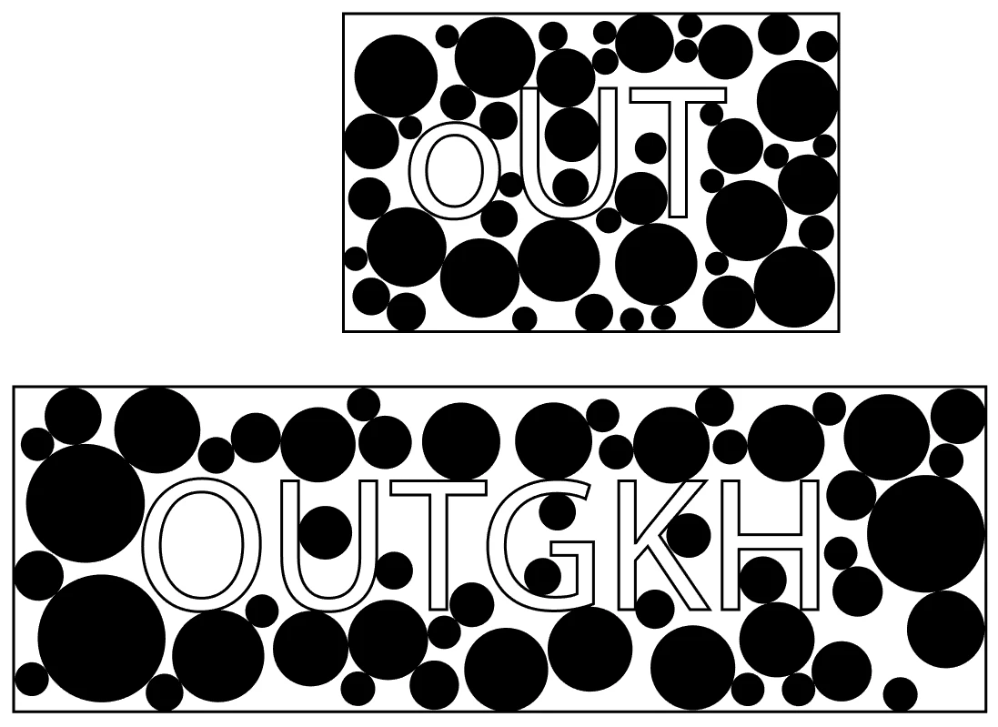

Does someone have the time to track down what the possible problem could be with my CircleFill script? See [Ann] Design effect - image made of perfectly arranged circles​.
As lisapru notes (see down that thread), it fails to work on a background slab with the text punched out. Not only does it 'not work', but it also does so silently; no error, no warning, no change, and nothing in the Undo stack either.

Hi [Jongware]​,
if I understand you right, sometimes your script fails without an error if an outlined text was substract from a rectangle?
If the text was outlined you have to release the group at first. After than you can create the final compound path with your background rectangle. The script works correctly for me.
But if you create the (final) compound path with
- a group of outlined compound paths
- and your backgroud rectangle,
your script fails. Sometimes Illustrator crashes. I don't know why. Mostly the mistake seems to be in line #218
if ( innerpaths[0][0] < innerpaths[innerpaths.length-1][0])
undefined is not an object
Perhaps this helps you a little bit.
Regards pixxxelschubser

I got some pretty inconsistent results, but I don't think it depends on whether the text was grouped or not before punching it out. I got the same error at that line, and ... wow. It's a mistake – and it's a biggie
Look:
The idea here is to check the first point of a path against the last one. The paths themselves are the first array index, the next is the line index, and, if I remember correctly at least, the third one is the point itself. Now look at the part I bolded. It uses the length of innerpaths itself – not that of the nested array ...
It should be
– see? The length of the sub-array, not of the parent...
