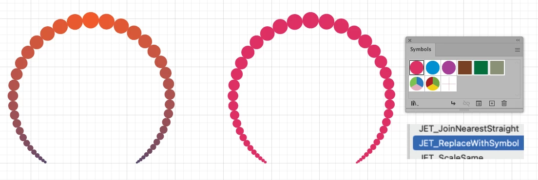

Wesley, hi
I random color as I work.
To recreate, I used a Blend. 3 circles.
I used Blend Steps 21
Expand Blend Steps and ungroup.
Align Panel: I used Distribute Spacing of 0.
Group your circles.
Make your overall art nouveau shape circles.
See that purple stroke, I know that size 595.546 pt.
Next, I made a Pattern Brush that same size.
Then I applied the Pattern Brush that purple stroke.

Doug A Roberts
May 2, 2024
Just to note that this may be ok for your needs, but it will produce ellipses that are fatter at the top than the bottom, not circles.
kphotopage
May 2, 2024
Doug, I see what you mean.
When I expanded the pattern brush, all those circles were not true circles. Just slightly off.
To correct, I ungrouped and applied script JET_ReplaceWithSymbol.
Break Link to Symbol if want.
All shapes are true circles. Closed path, 4pts
K
