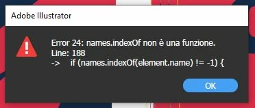

It seems to work but i batch execute it and on every file it gives me an error (Error 24: names.indexOf is not a funcion):
I press ok and the script keep going on the next document and so on..
The result seems to be ok but i don't know why this error.
Any idea?
Thanks!
Charu Rajput
Charu RajputCommunity ExpertCorrect answer
December 12, 2022
You will not find indexOf() method in jsx script. You need to include the proptotype of the indexOf() method. Not sure what exactly you want to achieve. If you can explain better with some screenshot that will be helpful. Also, you can try following version that includes prototype of the indexOf()
