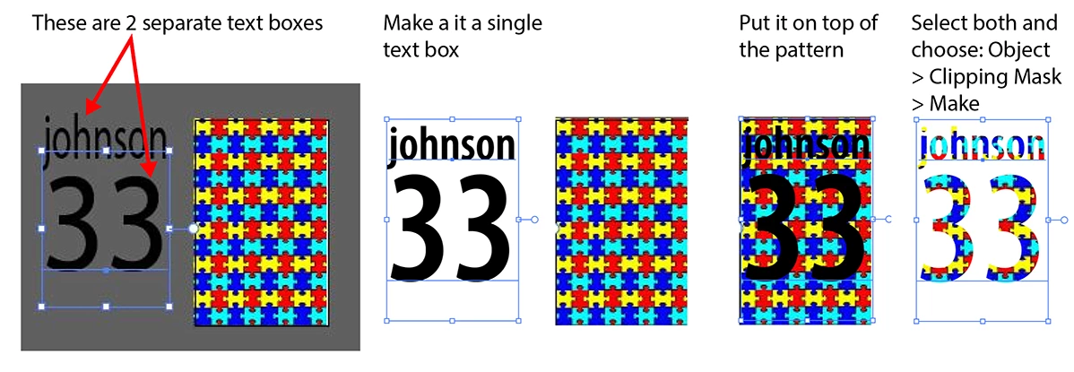

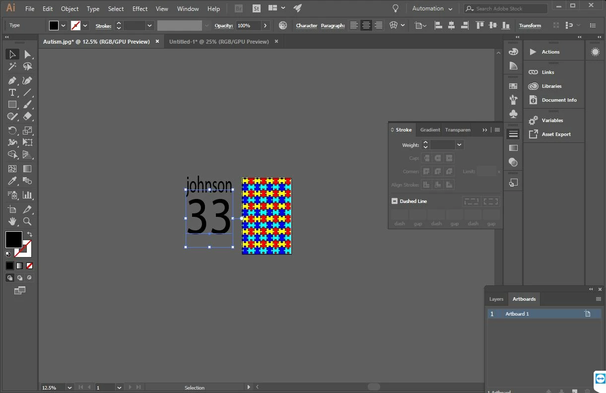

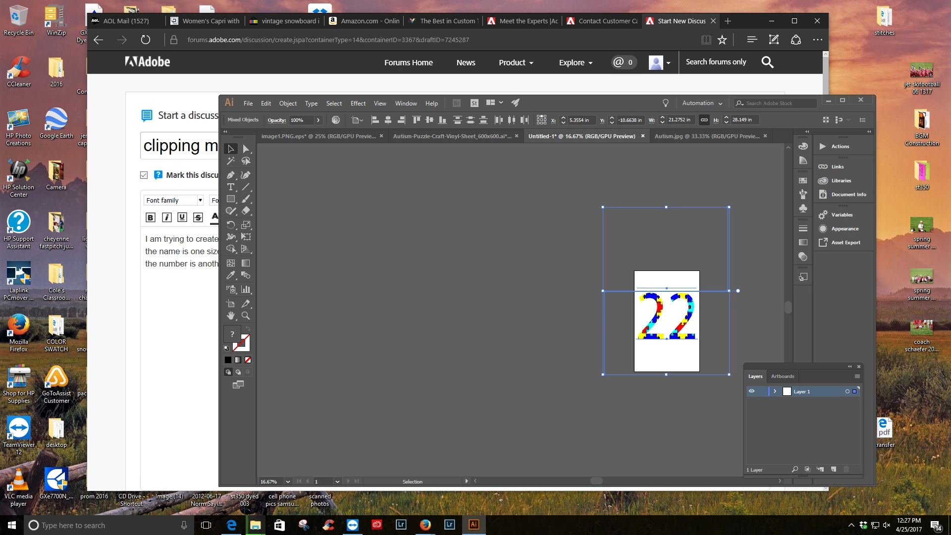

I am trying to create a clipping mask with a name and below it a number
the name is one size
the number is another size.
I have tried to make a compound path of the name and number, but that option is not there when I try it.
There is a name above this number that disappears when I do the mask
    Correct answer Myra Ferguson
    Put the name and the number in the same text box even if they are different sizes (adjust the leading as needed). Then make the clipping mask.

    Like Myra said, make a single textbox:

    well I give up, this is what happens when I follow your tutorial ..  I have tried with a jpeg image, ai image, this is not supposed to be this difficult is it?

    You can use only one path (or text) as clipping mask. You are right to prepare compound path. But. You have to convert text into Outlines or use Myra's mtehod - - prepare one text object (one frame) with text. Use Character Panel, Paragraph Panel or Touch Typoe Tool to adjust text settings and then use one object as clipping mask.
    Mask Mast be a single object (or compound path)
