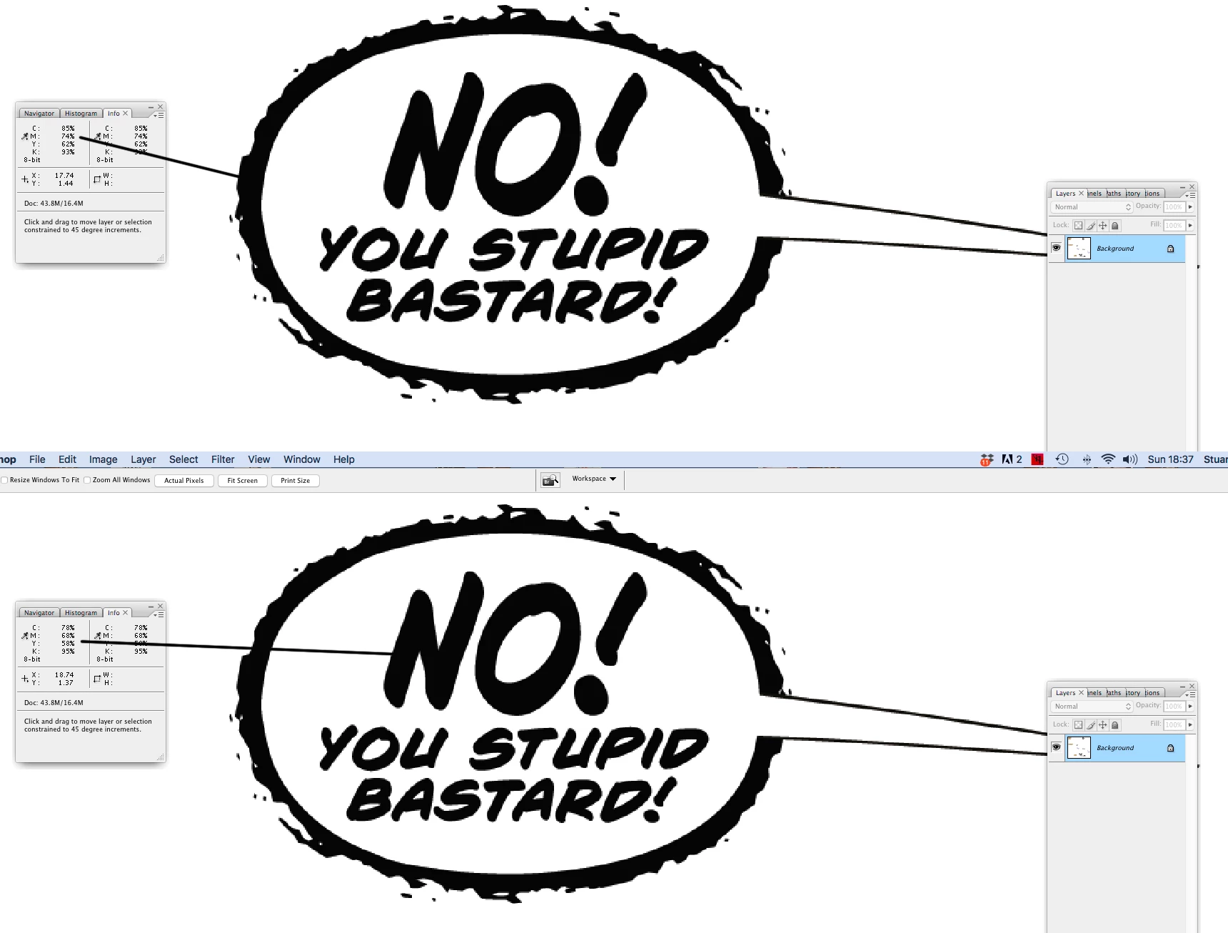

Hi there, hoping somoene can help me. I have a CMYK Illustrator file and the mix of black on some parts is changing when I bring it into Indesign. All other colours are staying the same and it's not happening to all parts of the file, just some. Has anyone else had this issue? Thanks

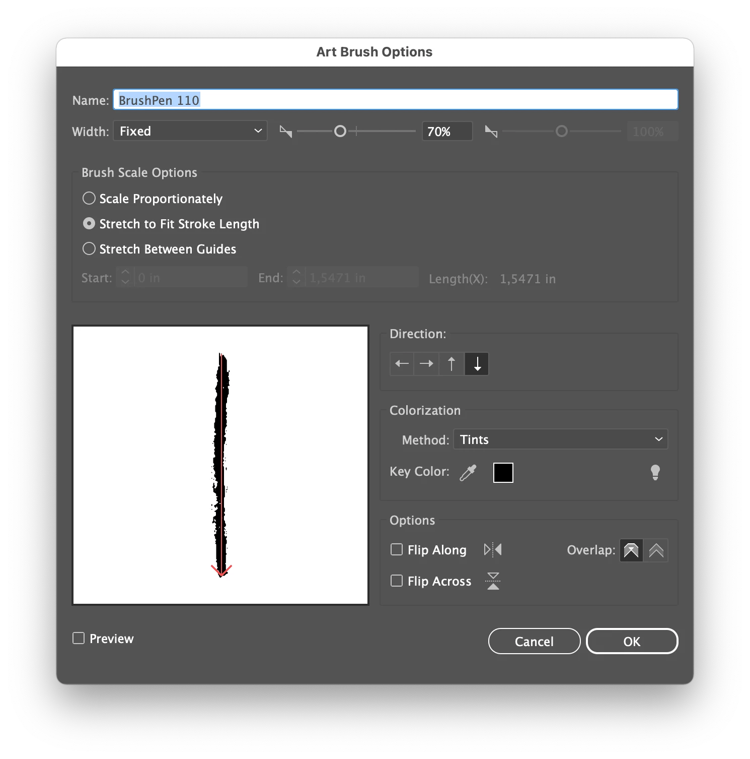

Thanks Stuart, yes, let us know how it goes. Art Brushes can give surprises, a lot of them are CMYK  based and do not give an RGB black in RGB documents (but that is a different problem).

Thanks, the difference is caused by the Brush settings.
If you change the Art Brush Options Colorization method from Hue Shift to Tints  the color will match.

October 30, 2023
Yes, they're both ISO Coated v2 300% (ECI). I'm attaching a jpeg to show the issue. All blacks should be 78c 60m 58y 95k. The type is staying the correct mix but the speech bubble is changing
