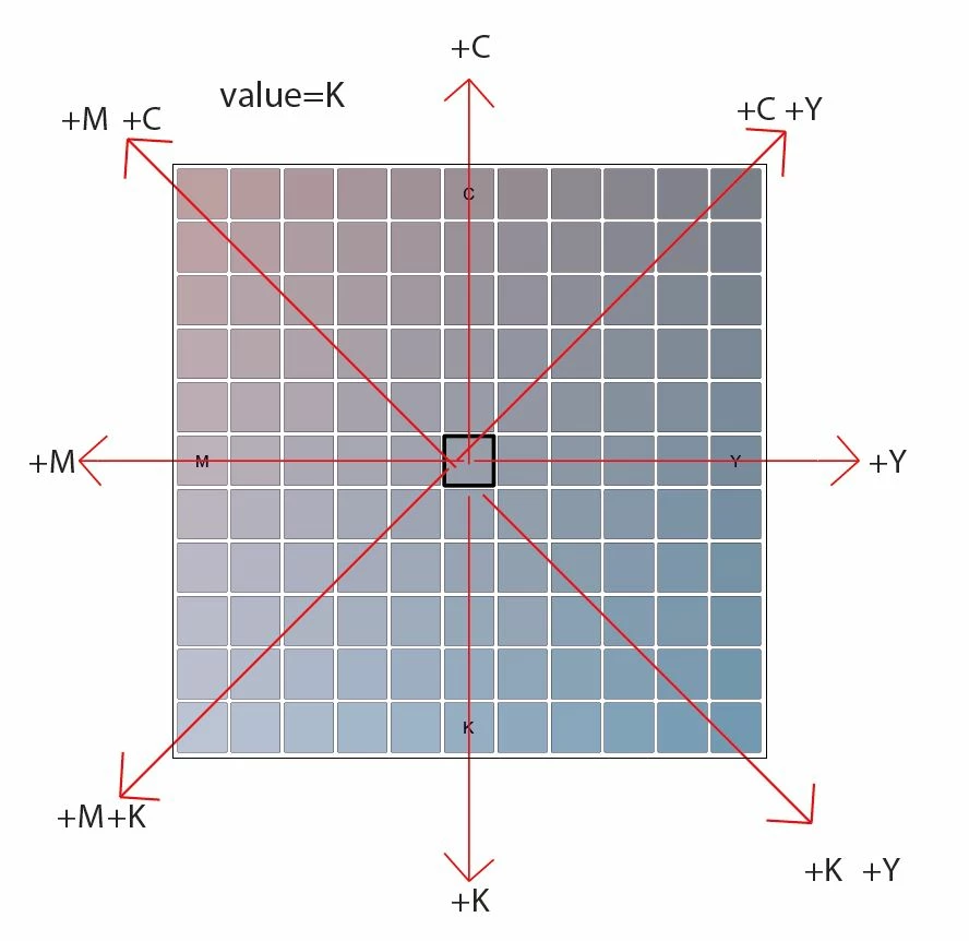

Could some help me with creating table and change CMYK values by k value.
Or know where can I find such a script.
So i have base CMYK value in center. I want to add values to separate chanells.
example: center 50/50/50/50 , k value =2
to the right will be 50/50/52/50; 50/50/54/50; 50/50/56/50; 50/50/58/50; 50/50/60/50
to the left top: 52/52/50/50/50; 54/54/50/50; 56/56/50/50; 58/58/50/50; 60/60/50/50

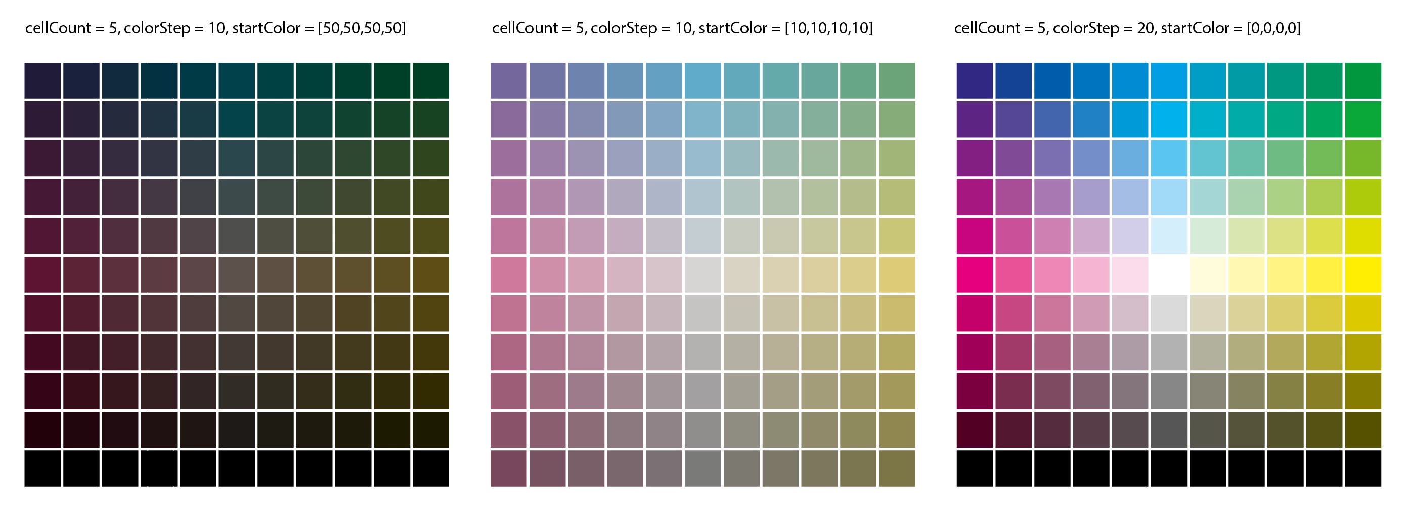

Hi @grafik2_5837, I've written a quick script to do this. Give it a try and let me know if it works for your case. I've configured the `adjustCMYKColor` function to match your logic. You can set the `cellCount`, `gap` and `colorStep` values.
- Mark
 * @file Make Color Grid CMYK.js
 * Usage:
 *   1. Draw a square in Illustrator, the size you want the color grid.
 *   2. Color the square (in CMYK for this example).
 *   3. Run script.
 * Draws a grid squares over the selected square, with the original color
 * in the center, and with colors radiating out with modified values.
 * Color values are modified by the `colorFunction`, eg. the example `increaseColorValues`.
 * @author m1b
 * @version 2025-05-30

Edit 2024-10-01: oops, forgot to add screenshot.
Edit 2024-10-01: added UI.
Edit 2025-05-30: fixed bad bug—a typo—that I must have introduced during the last update that ruined the whole script (it's been broken for 7 months! Sorry!) Also added a "AutoStep" settings and UI. AutoStep means it calculates the step amount for a color such that the outer grid square always is 100% of that color. Turn this off if you want exact control. I also included an example custom drawCellFunction that draws the main cell plus three smaller, darker cells over it. This example is currently commented out.
- Mark
October 1, 2024
WORKS BRILLIANT !
Thank YOU !
Save amount ot time is our Print House.
I'm not imposing, but could a window appear in which we enterColorStep manually.
If not will create separate scripts
THANK YOU again !
m1b
October 1, 2024
Good to hear! I've put a UI on the script above, so try the new one.
