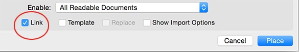

Did you check the Link option in the Place dialog when you placed the image?

Muchas gracias! Era eso

Ton FrederiksCommunity ExpertCorrect answer
November 7, 2016
