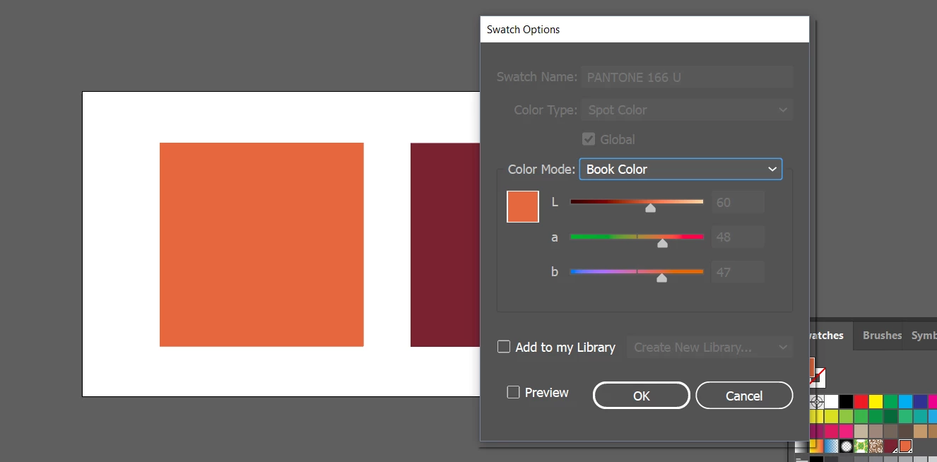

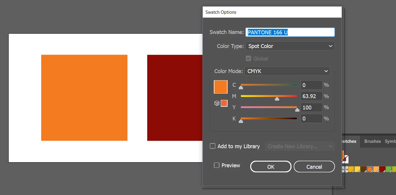

I am having an issue where color modes of swatches are automatically converting when copy/pasted into a new document.
Here is an original:
I am creating a new document, trying to copy/paste logos and other elements (not just squares in the example) and when they are pasted in, the color swatches are automatically converting to book color. As you can see, that is causing a significant change.
How do I prevent that from happening? Both documents are CMYK.
Thank you!
    Correct answer Mike Sofa
    This will not happen if you avoid using misleading names for swatches. The swatch in the original is called "PANTONE 166 U" which is the name of an actual Pantone color. But it's not a Pantone color, it's a CMYK Spot color.
    If you call the swatch "PANTONE 166 U CMYK" or "64M 100Y" or anything else besides an actual Pantone color name, it will not convert.
    It's not good practice to give swatches the names of actual Pantone colors when that's not what they really are.

    hrvvAuthor
    July 11, 2018
    Thanks Mike! Renaming the color swatches did the trick.
    Not to make excuses, but I inherited a library of files from another designer and just missed that technicality. I am aware it's not a good idea to name things like that, and that's one of a variety of other things I need to do to recreate all the files using best practices.
