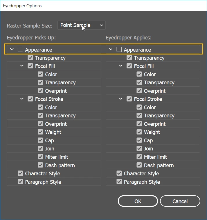

    Double Click the eyedropper Tool, and Make sure "Appearance" is Turned off.
