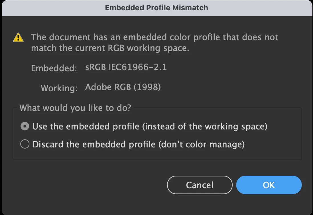

When I open the file, I get a window that says the document has an embedded profile that does not match the current RGB working space (Fig. 1). First of all, this is to be printed, so it should not contain any RGB images (I assume that the window is indicating that the file contains imported RGB images).

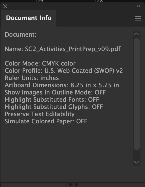

So I click to use the embedded profile (several times), and the file opens. The printer requires that the pdf use the ICC profile "CGATS21_CRPC3". As you can see, the document info windows tells me that this pdf uses "US Web Coated (SWOP) v2 (fig. 2).

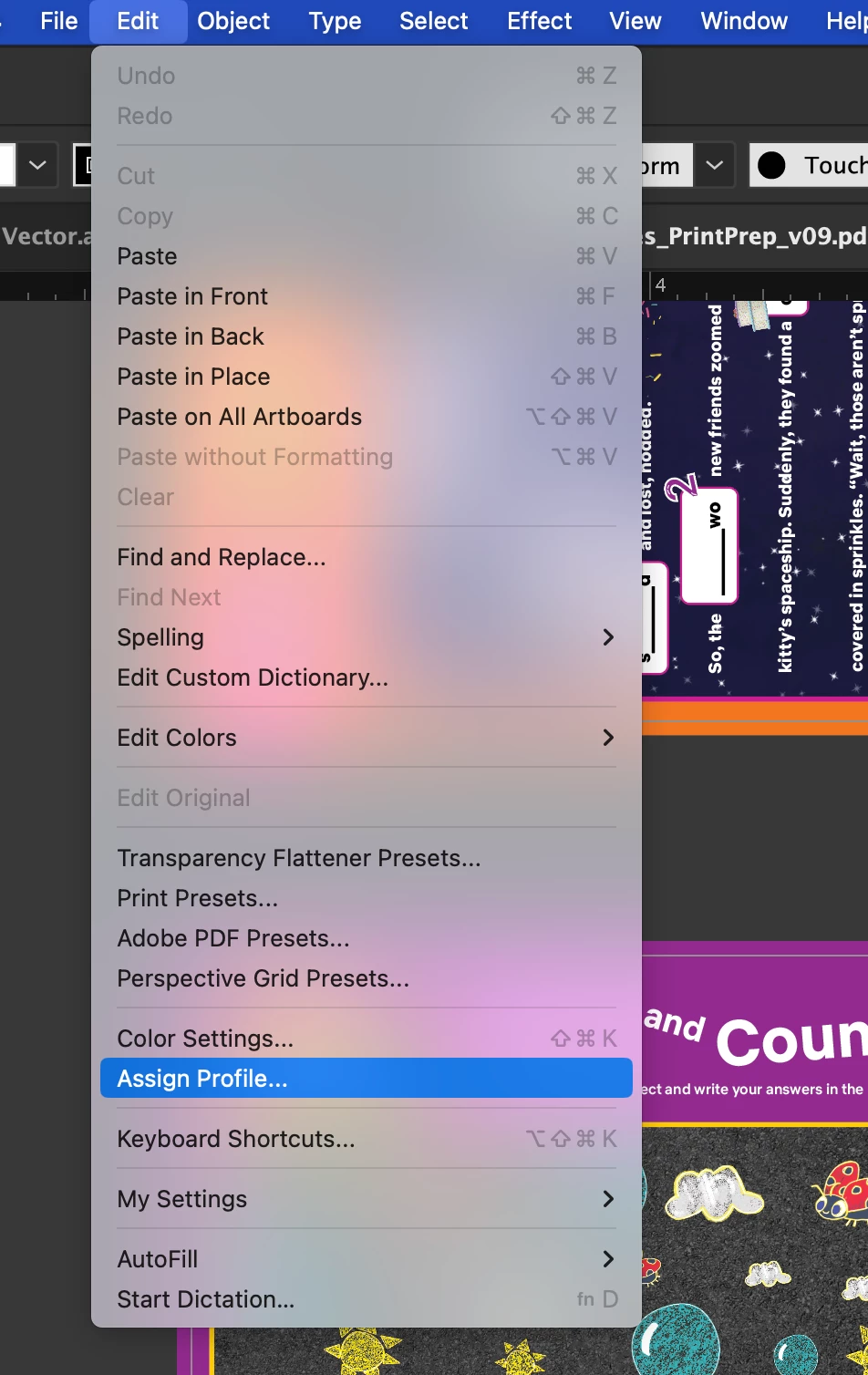

The printer sent the file back and said to change the profile to the correct one. What's the best way to ensure that the file uses the CGATS21_CRPC3.icc profile? Should I change the color settings in Illustrator so that the working space is using the correct color profile, then "assign the profile" to match the working space? Or should I leave the working space alone and just go to "assign profile" and use the drop down menu to select the correct profile?

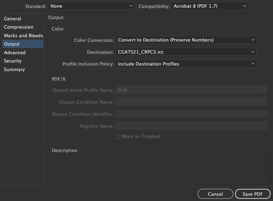

Then, when I save as a pdf, is it correct to select "convert to destination (preserve numbers)" and choose the CGATS profile as the destination (as seen in fig. 3) ?

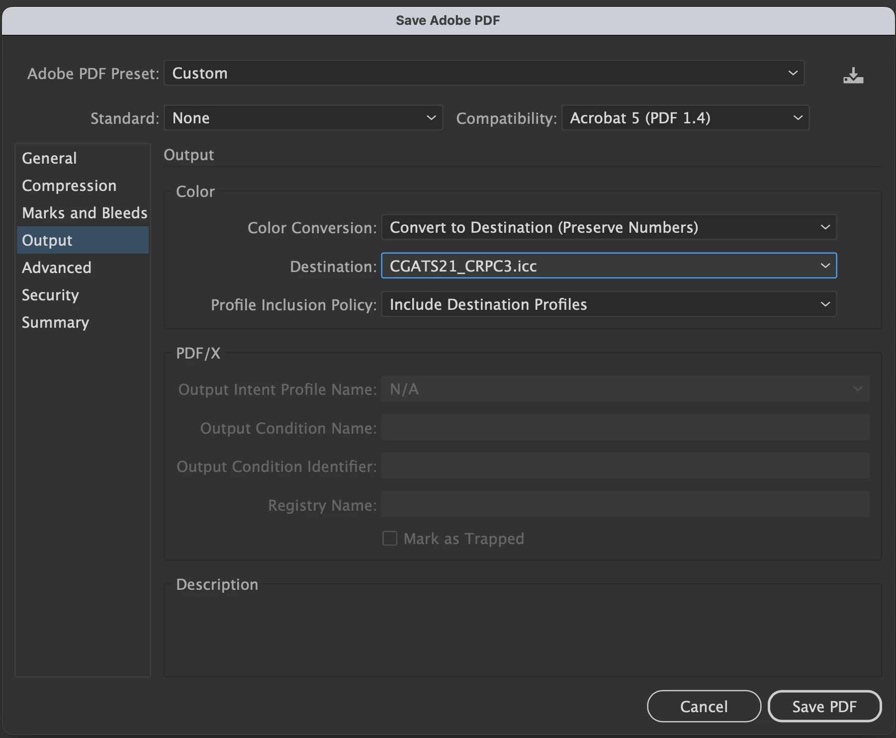

When saving the Illustrator file as a pdf, in the Output section of the pdf options there are 3 selections for color--Color Conversion, Destination and Profile Inclusion Policy
The selections I chose were these: For Color Conversion, I selected "Convert to destination (Preserve numbers)."  For Destination, I selected the profile required by the printer (which is CGATS21_CRPC.icc). For Profile Inclusion Policy, I selected "Include Destination Profiles."

Serene_observer5E99
December 28, 2023
The file is already in CMYK. And when I saved it as a pdf, I selected the options in the attached screen grab. Shouldn't that result in a CMYK pdf with the correct profile?

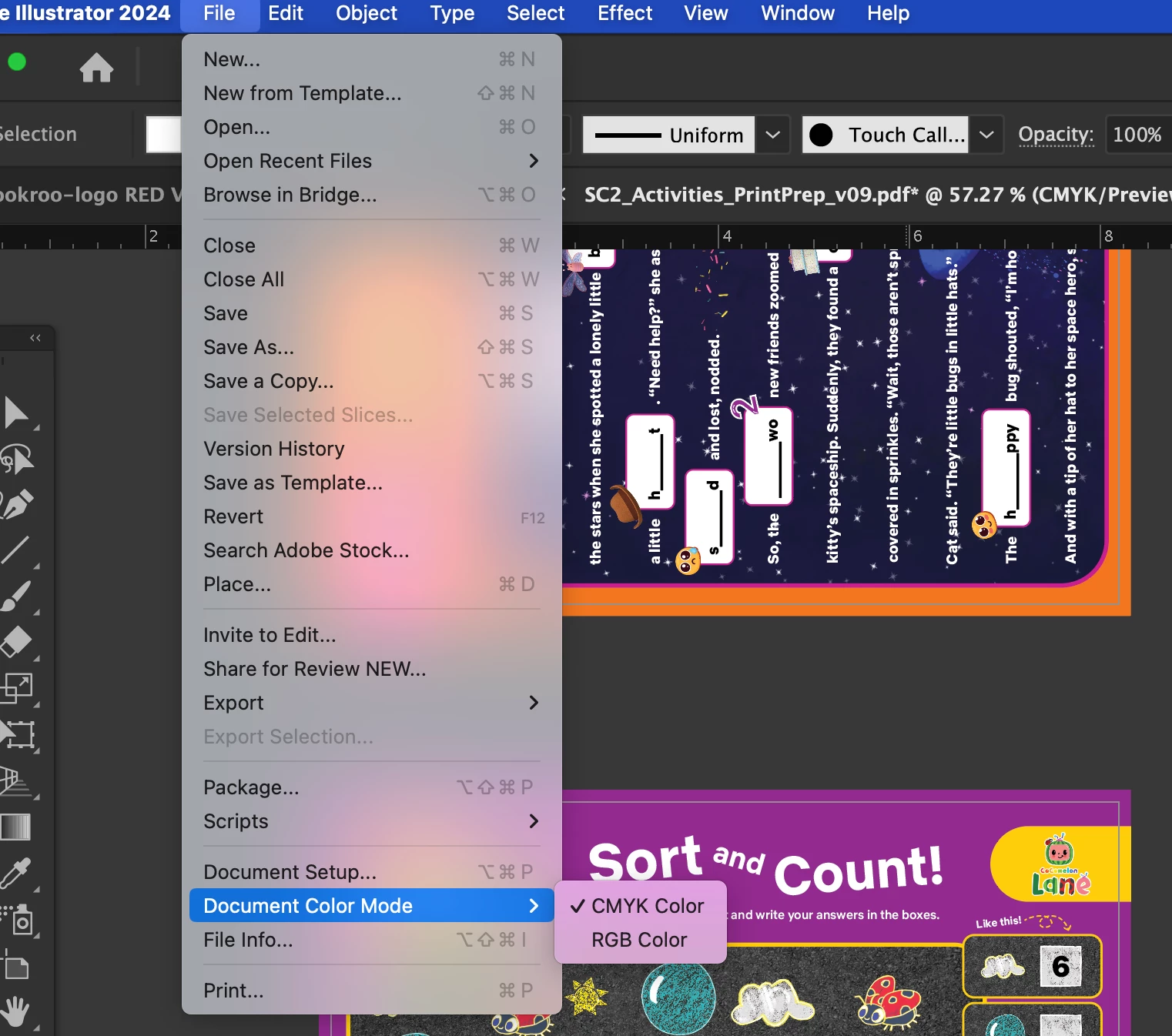

That's not correct. In the screen grab, you'll see that the document color mode is CMYK.

I assume you mean when I save the file as a pdf (fig. 2)? Or do you mean I should assign a profile in Illustrator (fig. 3)?
