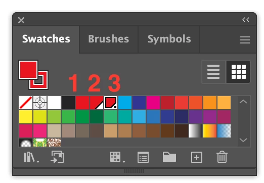

You may be working in RGB color mode but is the block of text a spot color?
January 20, 2023
Had to do a quick google search on spot colors, but if I'm understanding you correctly I took our hex code for the brand color and got the specific RGB values -- I referenced the color on the AI file and all the RGB values were already correct
Kevin Stohlmeyer
January 20, 2023
Ive seen this same behavior in Illustrator previews specifically on the Mac OS when a global color (or spot color) is used. Certain systems cannot rectify a global or spot color so it comes across as an alpha channel/grayscale preview.
1 is a normal color swatch
2 is a global color swatch
3 is a spot color swatch

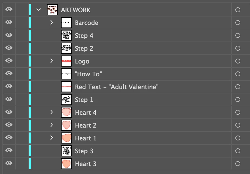

Please select that red text and show us the Appearance panel and the layers panel (click on the magnifier glass icon to find it in the panel)
January 20, 2023

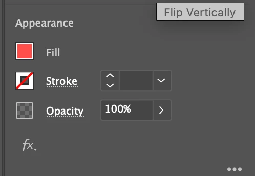

Monika Gause
January 20, 2023
Can you please show that in the Appearance panel, which is Window > Appearance?
I think there might be some transparency applied to the text. It might be in the red fill. This is the only reason I can think of that this might happen. Apple Preview is just not very good with transparency.
