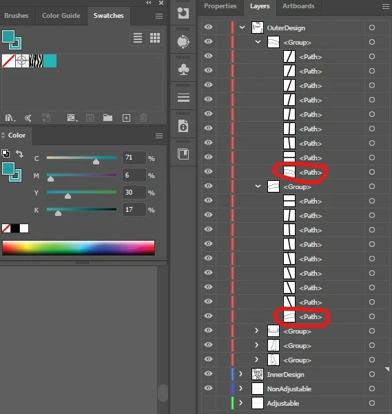

Hey guys,
as I´m still pretty new to scripting I once again reach out for your help. I got several files with the same structure and have to change the fillcolor of some layers and toggle their visibility. Here is a screenshot of one of those files (and the link TestFile ).
What I would like to do is fill the very last PathItem (red circle) of each group in the layer "OuterDesign" with the color C=71, M=6, Y=30 and K=17. In the layer "InnerDesign" also the last PathItem of each group should be filled but now with the swatch named "Zebra". At last the visibility of the layers "NonAdjustable" and "Adjustable" should be toggled so that "NonAdjustable" is invisible and "Adjustable" is visible.
But kudos to anyone that will help!!! 🙂

Charu Rajput
October 5, 2020
For your sample test file, please try following code
function main() {
    var doc = app.activeDocument;
    var outerDesignLayer = doc.layers.getByName('OuterDesign');
    var _groupItems = outerDesignLayer.groupItems;
    for (var i = 0; i < _groupItems.length; i++) {
        var _lastPathItem = _groupItems[i].pageItems[_groupItems[i].pageItems.length-1];
        var color = new CMYKColor();
        color.cyan = 71;
        color.magenta = 6;
        color.yellow = 30;
        color.black = 17;
        _lastPathItem.fillColor = color;
    var innerDesignLayer = doc.layers.getByName('InnerDesign');
    var _groupItems = innerDesignLayer.groupItems;
        _lastPathItem.fillColor = doc.swatches.getByName('Zebra').color;
    var nonAdjustableLayer = doc.layers.getByName('NonAdjustable');
    nonAdjustableLayer.visible = false;
    var adjustableLayer = doc.layers.getByName('Adjustable');
    adjustableLayer.visible = true;
main();
NOTE: For other documents, if the file is setup like this only, the script will work for all cases. But if there is any change in other document, (for eg: Change in layer name) it may possible script will not work. So just a suggestion, instead of changing script again and again its better to create a workflow so that it will works for all documents if you have more.
Best regards
October 6, 2020
Thank you very much! Works perfect and I definitely will keep your suggestion in mind 🙂
