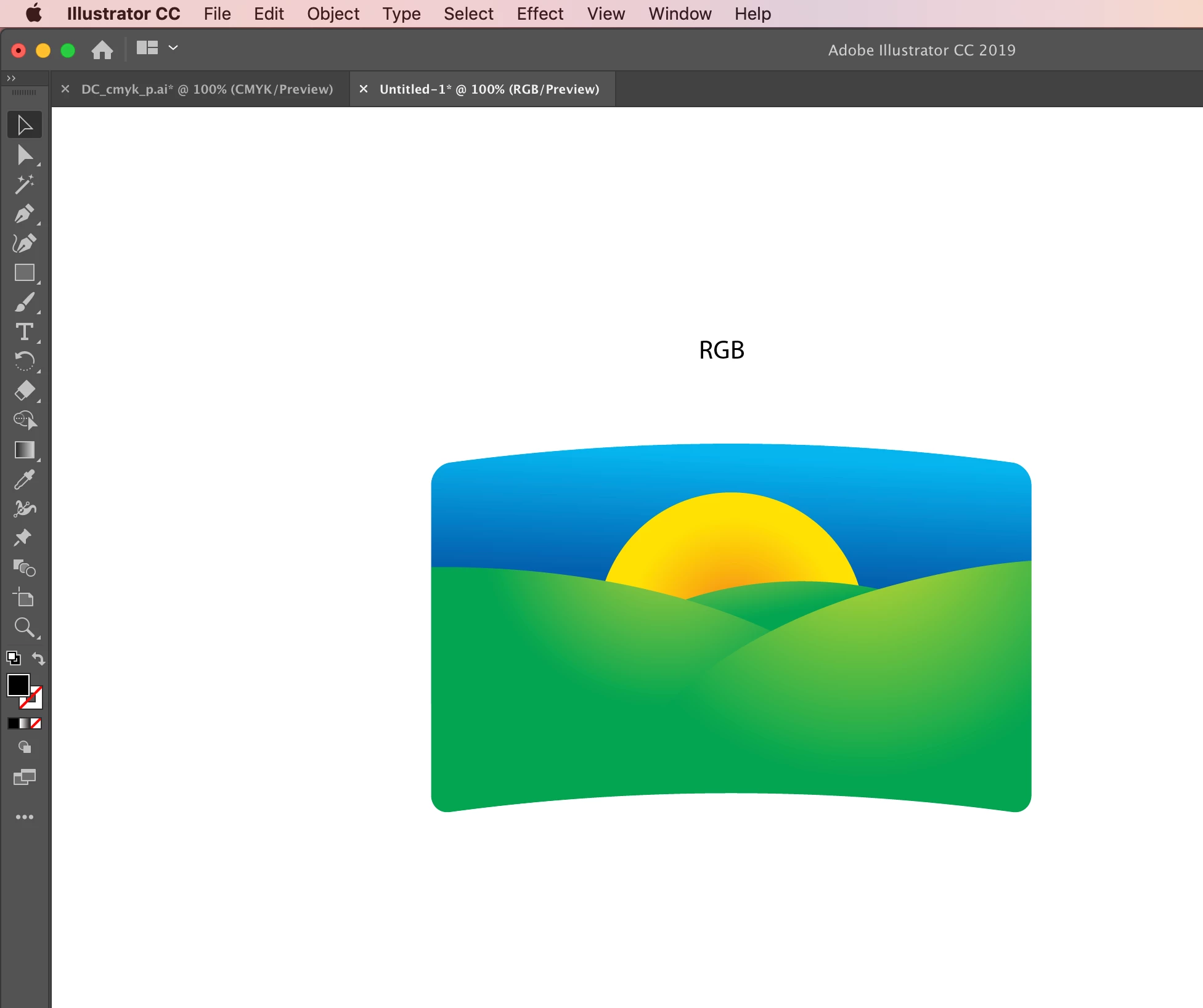

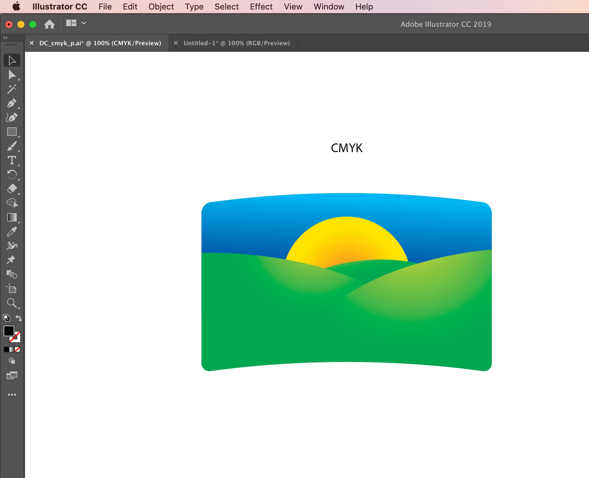

ldefazAuthor
February 16, 2019
Sorry, here are a couple of screenshots
Monika Gause
February 16, 2019
That's within a range that can be expected.
Especially with green you have to expect differences.
