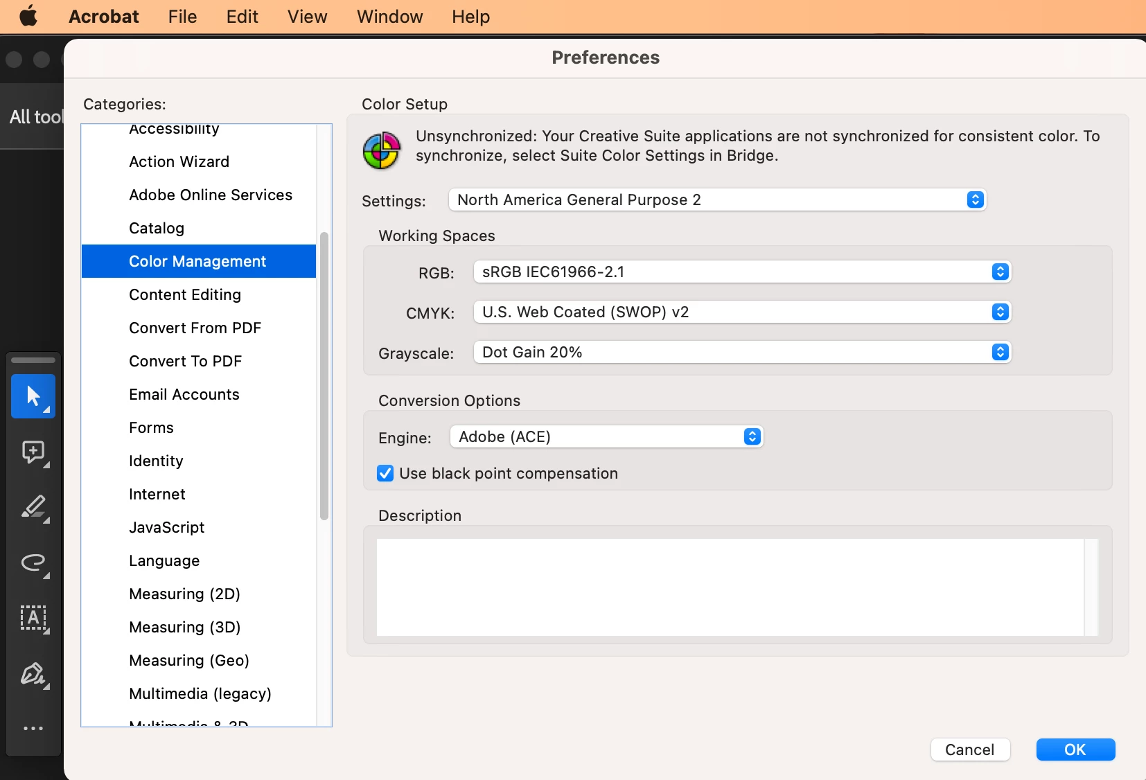

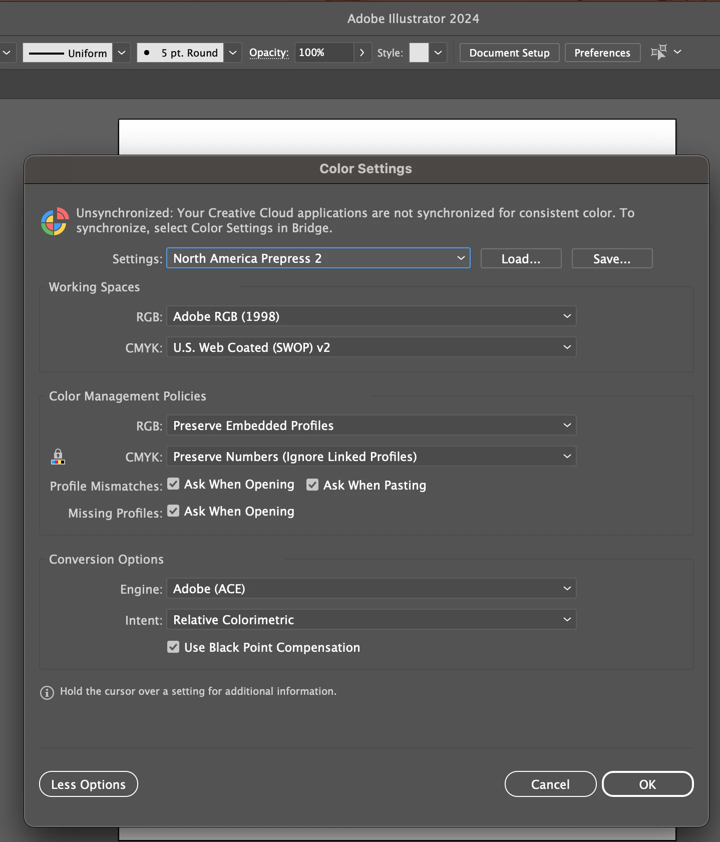

  • Check to see Illustrator and Acrobat have the same CMYK working space profile selected. This ensures consistent color interpretation within the software. (Edit > Color Settings in Illustrator). See illustrator.png and acrobat.png

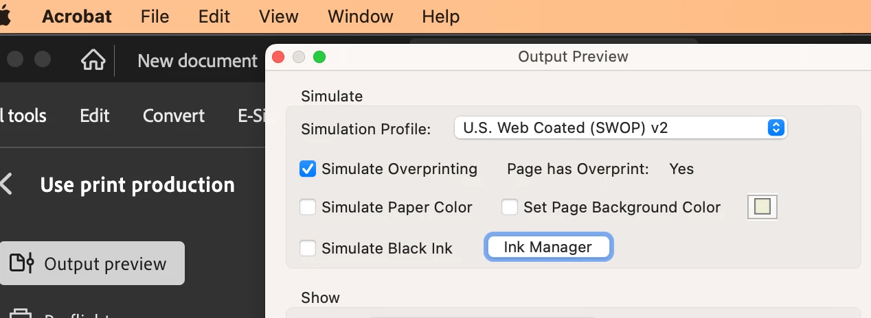

  • When looking at the PDF in Acrobat, use the "Output Preview" mode with the intended printing press profile selected. This simulates how the colors will appear (acrobatoutputPreview.png)

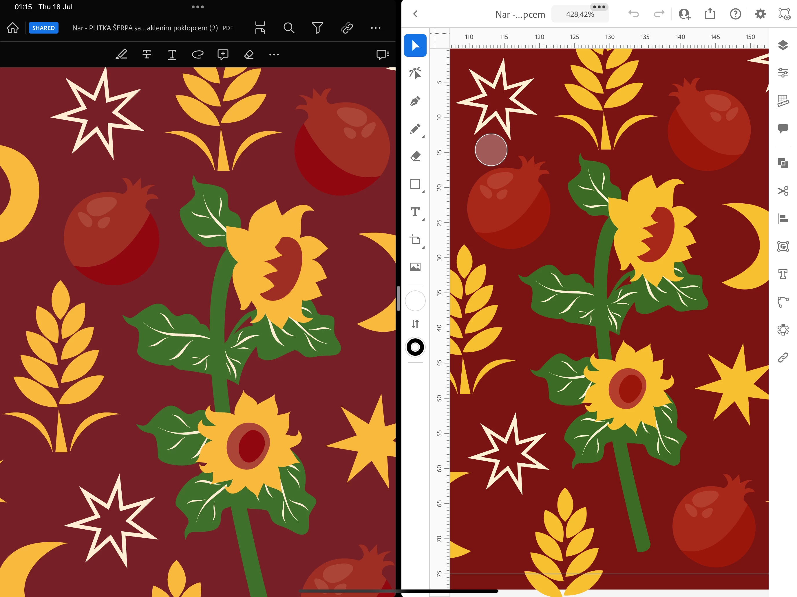

I will share a screenshot of the colour difference, on the left is Acrobat and on the right is Illustrator. This is on my iPad, but on the computer it is the same only everything is a bit duller, so the difference is even more pronounced.
