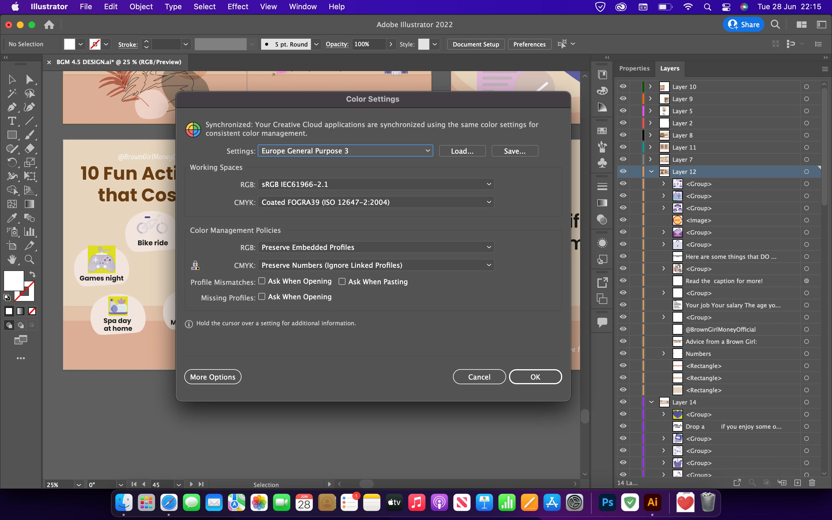

colours washed in imported pngs or images in illustrator when I reopen files
  • June 28, 2022
  • 4 replies
  • 214 views
i tried changing the color setting here and still have the same problem

Ther eis currently an issue going on with transparent PNGs showing in yellow. That is not your problem?
Can you turn on those warnings in your color settings? Is there perhaps a profile mismatch?

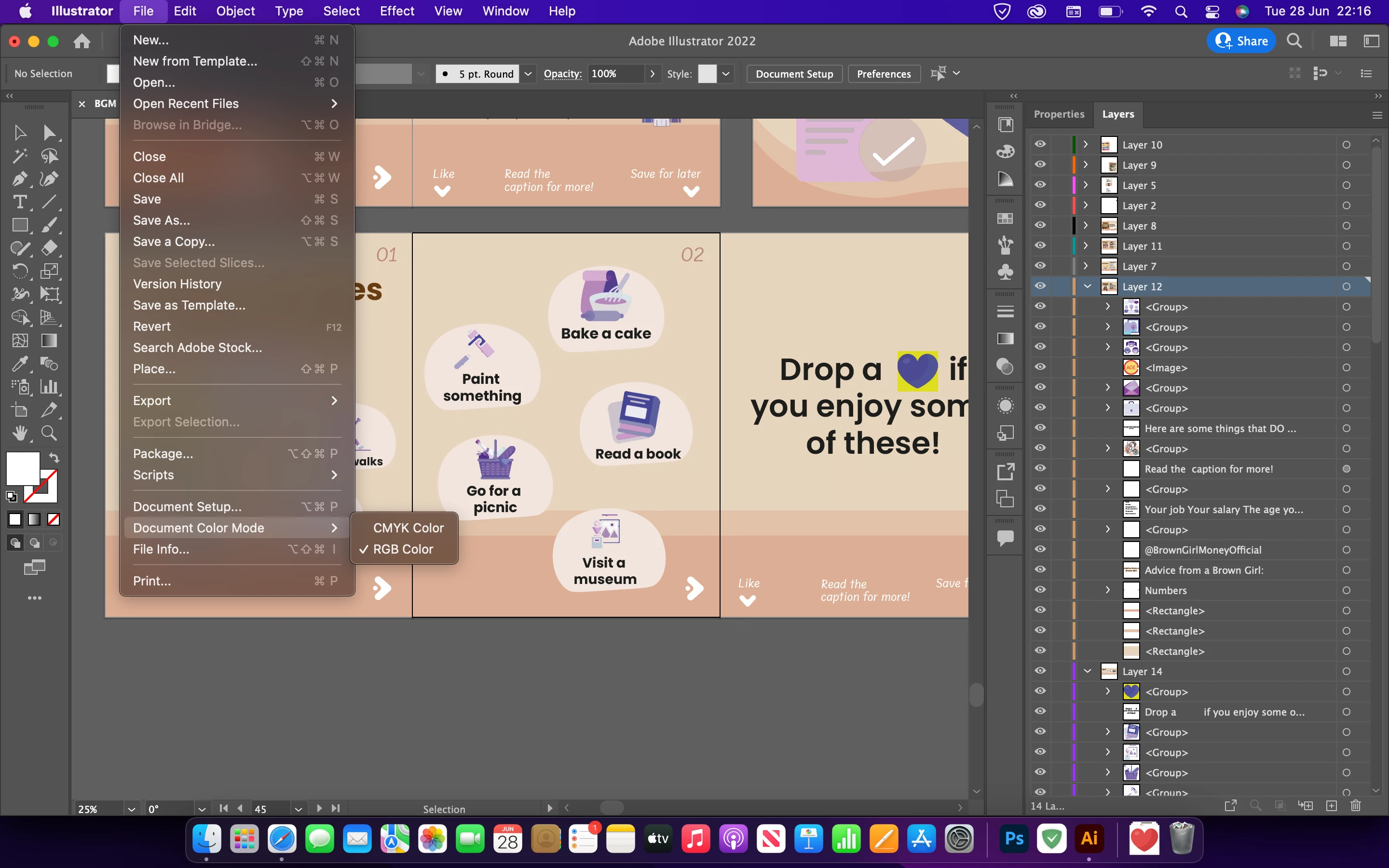

What the png color mode? CMYK or RGB? make sure that they are RGB same as your file
June 28, 2022
how do i check the png color mode?
