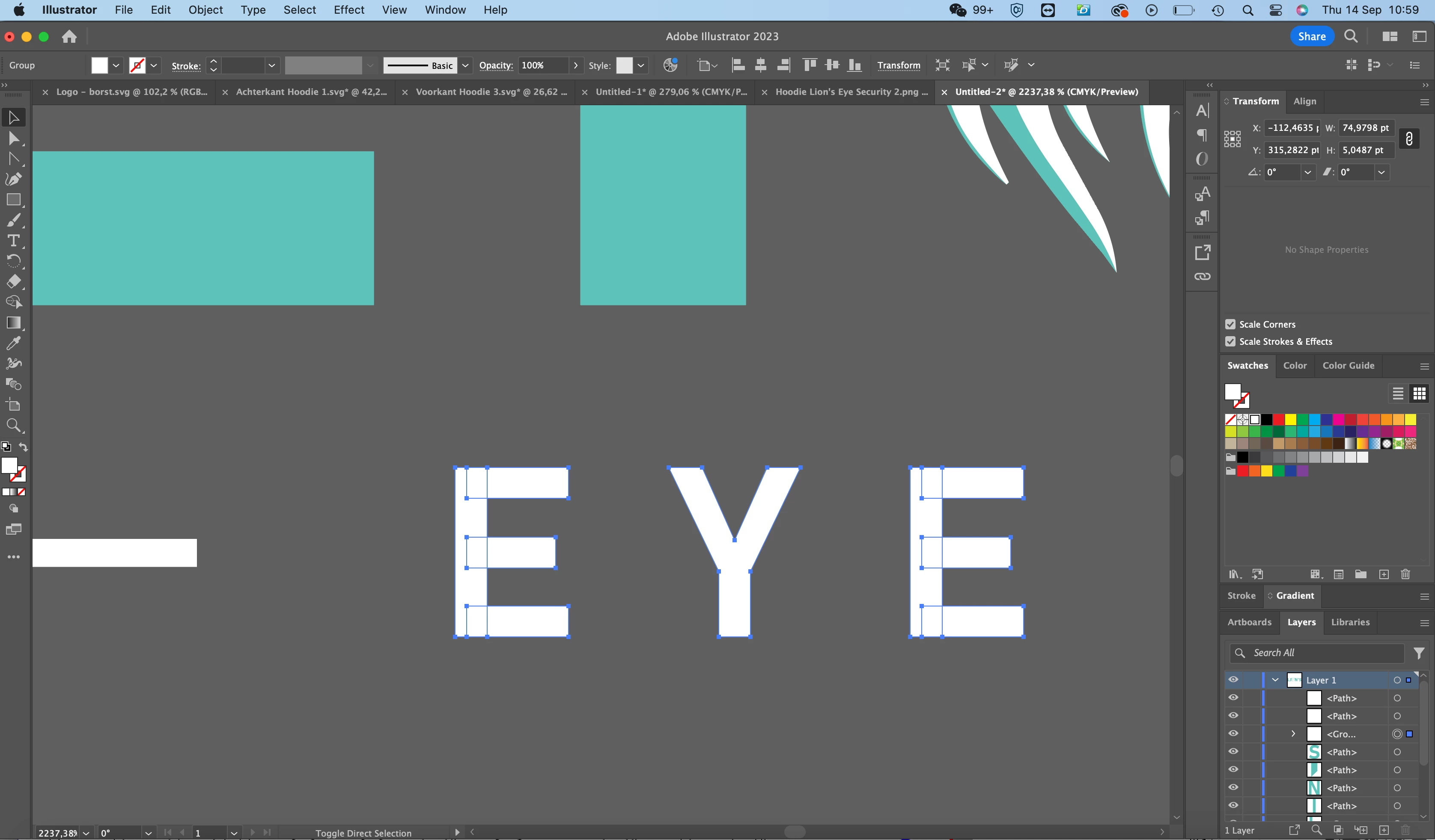

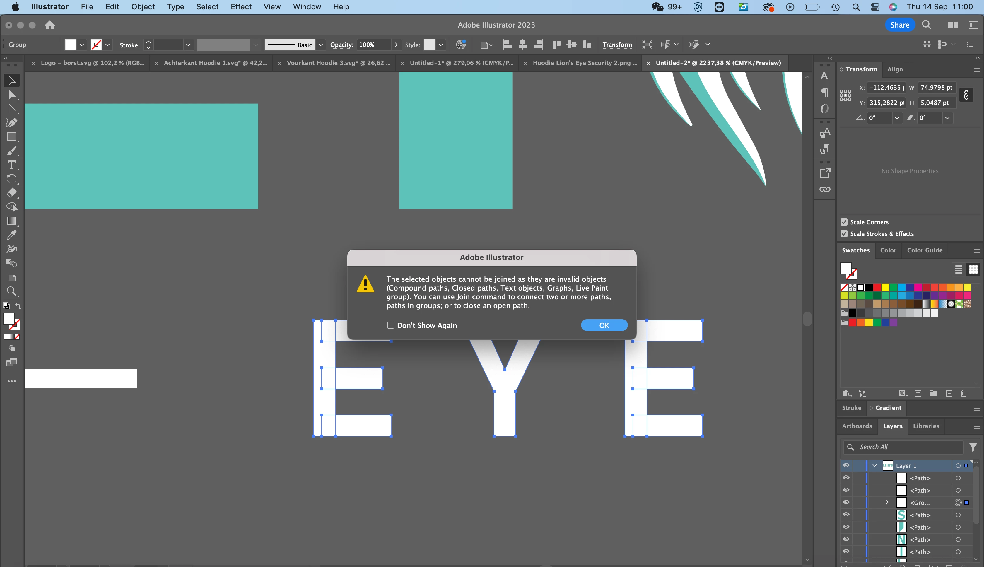

I am trying to combine several paths together so the outline will form the perfect cutting line. But I keep getting the error message: The selected objects cannot be joined together as they are invalid objects.
The the picutres you can see the E i need to comine all layers together so it will form one outline in stead of four indivudual objects.
Thanks in advance for all the support.

Open Window > Pathfinder and click on Unite (top left)
September 14, 2023
Thanks! You are the best! It took me hours to figure this out. Much more to learn.. 🙂
