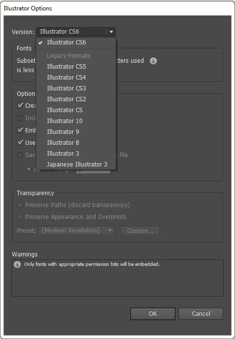

CS6 can definitely open the CS5 saved native Illustrator ( .ai ) files. In order to open the files saved from Illustrator CS6 in CS5, you would need to save the file to CS5 version.
Illustrator provides you with the option to save a file which is compatible with its earlier versions.
This can be done by selecting Version as "Illustrator CS5" in Illustrator Options dialog which appears when saving .ai file, shown as below:
This saved file can be opened in Illustrator CS5 without any warnings..

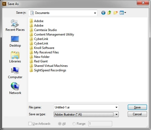

Wow I have tried for 30 minutes to figure out HOW? your getting this cool drop down menu that allows you to choose the version you want to save your file as...
I need to save a CS6 format for a user that only has CS3
could you explain how you are getting that window?
this is what I get for CS6...
Thanks for any help with this
tromboniator
February 13, 2013
In the Save As window shown in your screen shot click the Save button. The next window to appear is the one with the Version dropdown.
