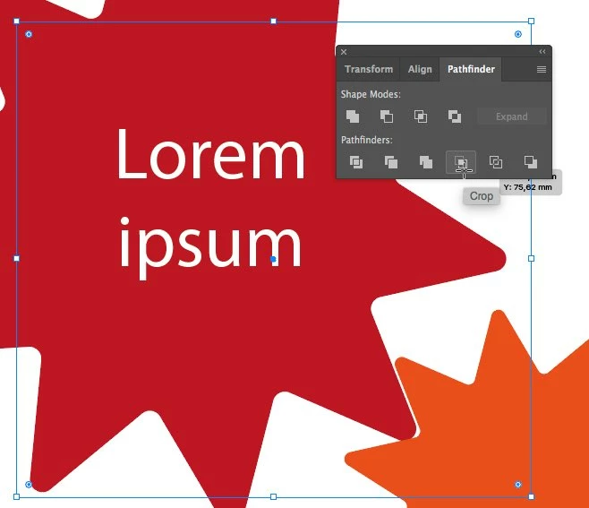

Please show your artwork.
The pathfinder Crop might not work, since it creates shapes.

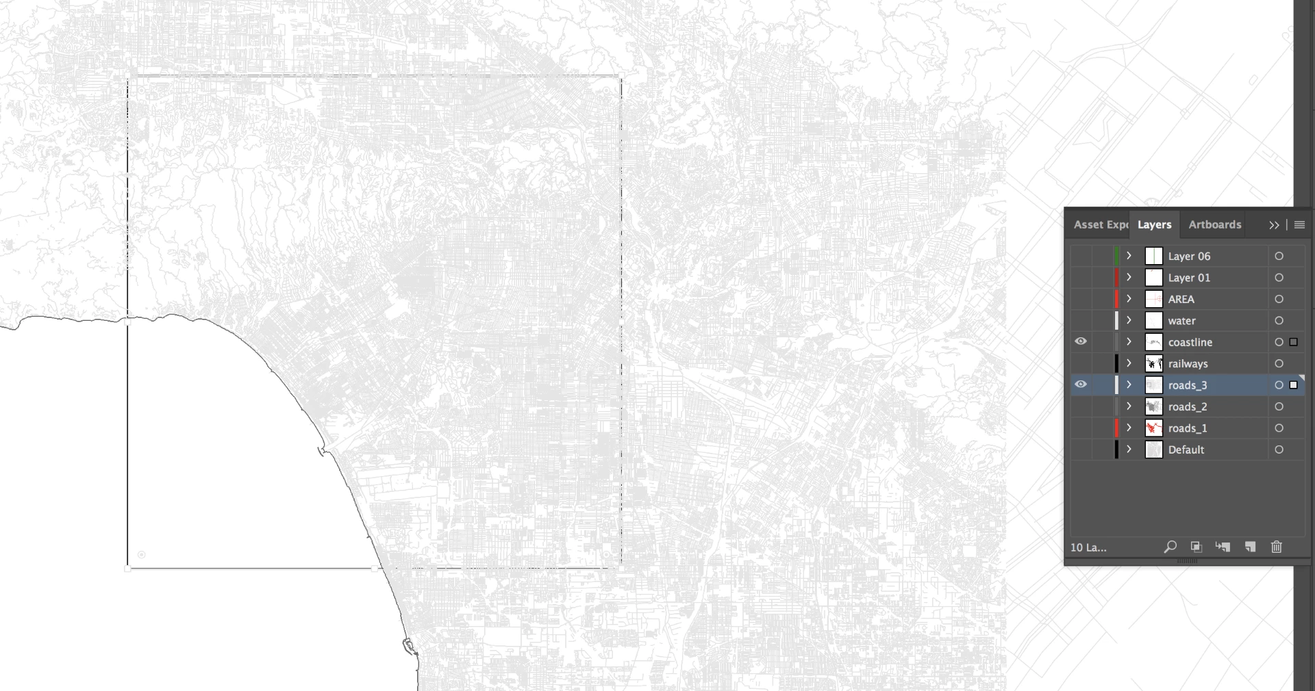

It seems that my case is a little different.
Please see the picture attached. Pathfinder cropping had no effect.
My artwork is a myriad of lines representing a city map. I need just a small part of the city.

See Mylenium's answer.
October 20, 2017
The Pathfinder will provide you with a solution.
1. Make an empty frame above everything.
2. Select everything, then go to pathfinder and find crop.
3. It will erase everything outside the box you've drawn.
